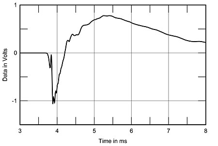

What do-you think of this ?
Response curve:
And group delay:
Yes.
THx-RNMarsh
My girlfriend at the time noticed it. I think I didn´t say anything.Not married ?
T, your frequency response curve is great, but your time response curve is marginal.
Richard, your time response is great!

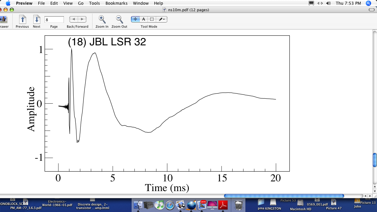

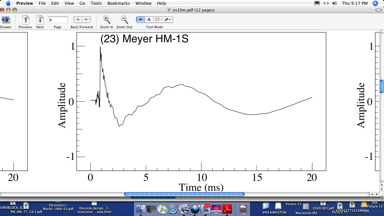

However, here is another (older) JBL that does not look so good:.
VERY Nice.Don't feel bad, T. Look at the time response of my Wilson Sasha speakers:
But don't fool yourself, analysing the one I showed. Those enclosures use a digital active filter with DSP.

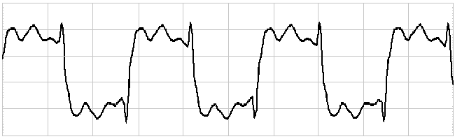

I was able to get midrange freq area to produce a square wave -- at the cross-over freq. Back before there were PC's and DSP. All analog.
I designed and built a opamp based cross over which I could continuously vary the slope and freq. I still have it in storage. I could get a perfect time and phase match between drivers. One driver (Mid-High) I was able to move forward and backward. Between moving it and adjusting the slope (phase), I could get a nice square wave. The mid-hi was a JBL LE175DLH (no longer made) that had a 90 degree spherical dispersion lens on the horn.
Now we have DSP and waveguides and powerful processing tools. But the fundamentals of what you have to get for accurate results has not changed.
