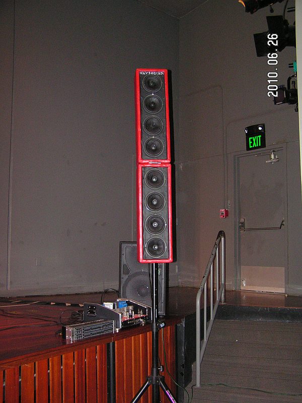

Yes. Of course, I do not mean rock bands. :D
That JBL on stage was not used then, it was in-house and could not be used for the concert: you know why -- directionality, frequency response... My pair of foldable line arrays with 2x80W tube amp covered the theater perfectly, for children concert (choir, ensemble, soloists...) -- there were five condenser microphones on stage that covered everything. They were dancing, singing, moving, average level was 75 dB.
Here you see the same speakers on open air: the same 3-4 feet from microphones. It was a bard festival, in the evening about 800 listeners assembled there.

First, Wavebourn, this is an awfully small PA system. OK for indoors, acceptable for picnics, but NOT a real concert, either folk, or R&R. That is reality. Too little power, too few speakers, etc. However, if it works for your gatherings, that is just fine.
As far as feedback is concerned, what kind of mikes are you using, directional or omni?
This is important when it comes to feedback, especially with outdoor playback. Look how forward your speakers are located. That would be impossible with a real rock or even a folk group with 100 people or more, attending. Still, I am sure that you do a good job, please just remember that some here do up to 500,000 people, and our methods are necessarily different.

Of course, it is totally different story, concerts for 500 and 500,000 listeners. And of course size of the auditory matters worsening the situation causing additional problems, but the principle is still the same: the flatter is frequency response, the higher sensitivity of microphones is allowed. The farther is the singer from microphone, the flatter that means is frequency response of speakers.
When I worked with rock band, I was more concerned of frequency response of on-stage monitors, in terms of feedback. It worked the same way. But I did not need such sensitivity then, because anyway instrument cabs and drums were quite loud on stage.
And, let me repeat, equalizing frequency response no matter in theater, in the room for home concert, on open air, I am getting almost the same cuts on equalizers, on almost the same frequencies that correspond to boosts of speakers. And they don't look like a comb filter, that's why I said that it sounds strange to me what Ed said about comb filter. I expected him to explain, instead of Stein to measure sizes. ;)
