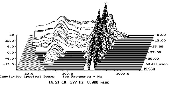

This is not any speculative model, this is a real speaker measured (impedance measurement) in a listening room. Of course that after addition of a resistor in series the frequency response has bumps and dips.
Of course without any additional resistor in series any real speaker has bumps and dips.
Here is the picture from the same Stereophile:

I was talking about broader areas of uneven frequency response. It is easy to take the frequency response, print it out and to then estimate for (say) third octave sections the effect of a 4 Ohm source resistance on frequency response and to then draw the corrections with a coloured pen into the original diagram.
Actually, even that is not needed, it is quite obvious that areas of broad elevated SPL in the FR are mirrored by dips in impedance and the reverse.
