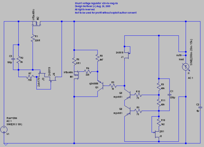

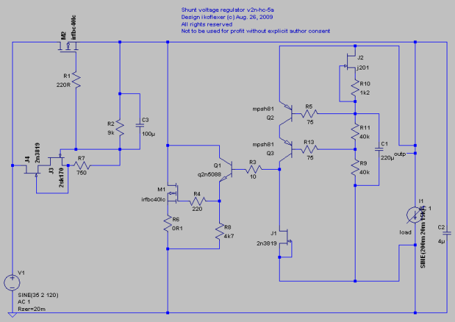

John, it might be easier to make comments on an example, and I know you don't publish schematics. Here is what I've been experimenting with, the target being DACs, headphone amps, or power amps (for those who don't mind huge heat sinks). So far I've tested it with some very nice results up to about 4A (20V out). The parts values shown should be taken only as indicative of the real parts, not an exact match. Because it's not targeted specifically at a particular circuit, I wanted it to have low output impedance, low noise, and very good psrr. I already got more ideas from you about psrr, so In the future I'll probably use a few regs in series for best psrr. However, the last regulator I'm thinking about shunt, as you see below.

Back to your comment about about choosing bipolars or mosfets. In the past you noted that you prefer to use an all jfet+mosfet circuit. I know this might be boring and old news for you, but since you said you wanted to teach us something, I'm soliciting your attention. Would you recommend to get rid of the bipolars in the circuit shown below?

Ovidiu, for everyone's benefit, can you please expand ? (I do know that a cap from the emitter of Q1 to ground messes up Zout in a big way.)
Joshua, thanks for the suggestions; as I said, anything that has to do with the passive parts is left as a tweaking exercise; I'm referring to resistor values, bypassing large caps with smaller ones, etc.
Any comments on the use of bipolars in the control loop?

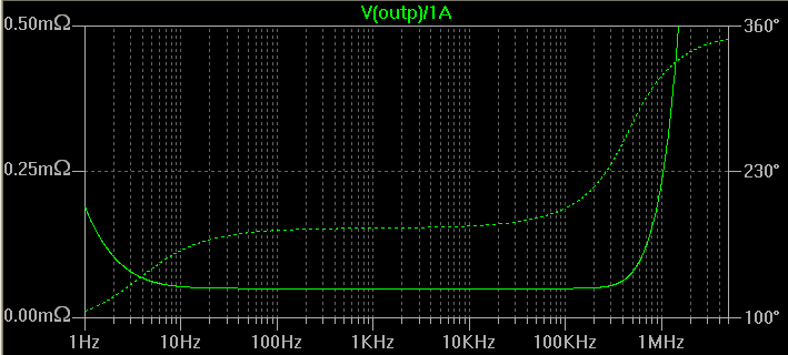

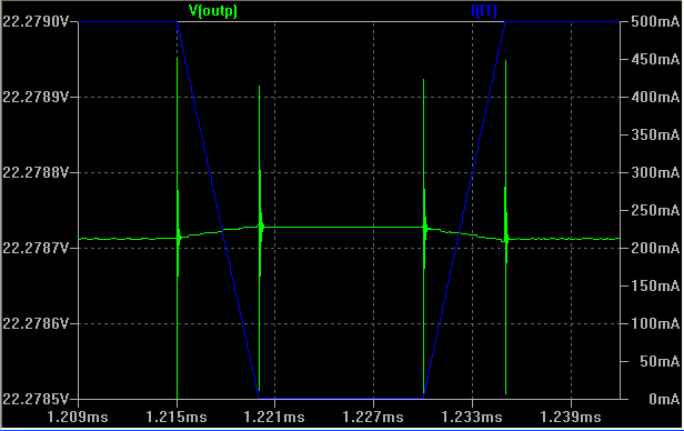

And before anyone bangs me over the head with it, as a disclaimer I'll say that I'm fully aware that such output impedance plots are only simulations and belong in the fantasy land of wishful thinking

Ikoflexer, I must be getting old (and I am) but I am having a hard time analyzing any subtle properties of what you have designed by inspection. Joshua's input while well meaning, is ambiguous, because paralleling a high Q cap can cause more ringing. We usually put our high Q caps next to the load, rather than in the regulator section.
