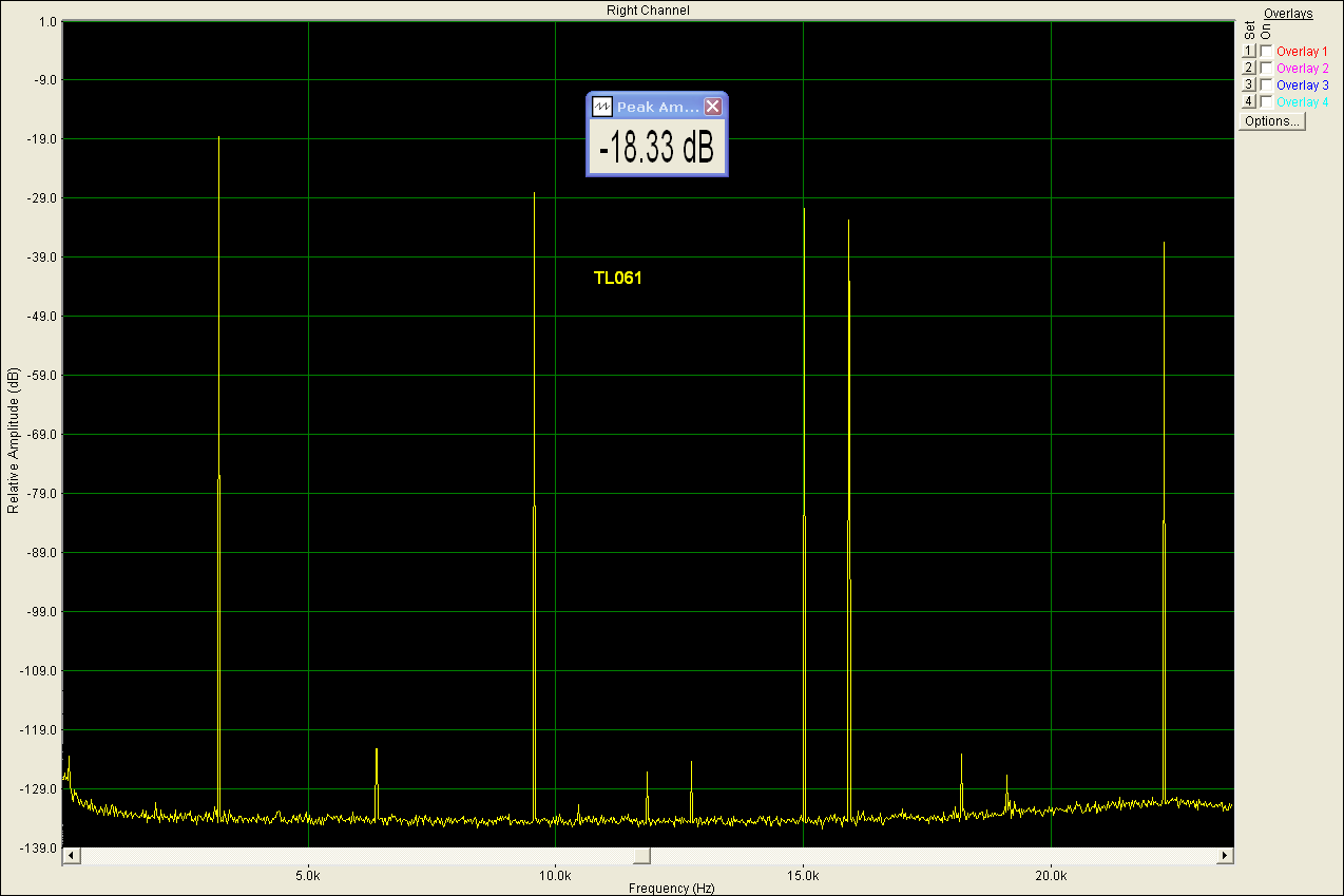

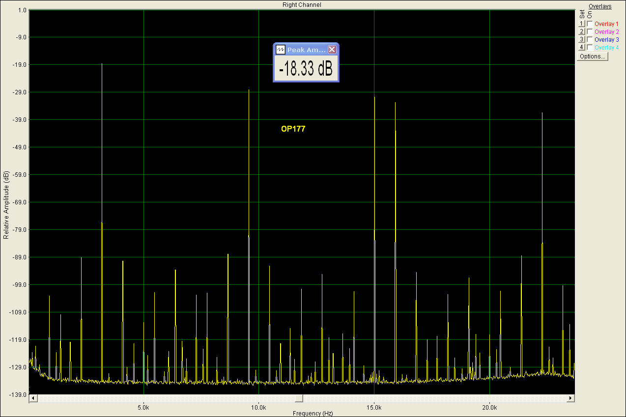

PMA, I think that it was 5V pp. for the 741 graph.
Could not find the 741. So I took OP177 (0.3V/us) and TL061 (3V/us). Test signal is 3.3Vpp. The test signal is bandlimited at 24kHz.
Let me check around I might be able to propose a simple experiment with the AD844.
I am all ears.
Pavel,
When I expand the 741 plot to full size and use my calipers, the basic spacing is 15mm.
When I set the calipers for 7.5mm I can account for pretty much all of the spectra above the -119 grid line, but a lot of the stuff below doesn't line up. Is this noise? Is it repeatable?
ES

Pavel,
ES
Simon,
firstly, the slow opamp is OP177, as I could not find the uA741.
The measurement is repeatable, and number and amplitude of the "stuff" depends on input signal amplitude, i.e. on the degree how much we approach (or exceed) the slew rate limit of the opamp under test. Here, the opamp slew rate is 0.1V/us - 0.3V/us (according to datasheet) and input signal seems to have slew rate about 0.15V/us. The more we approach the opamp slew rate limit, the more "stuff" we get.
Opamp's voltage gain is +1.
