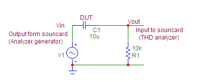

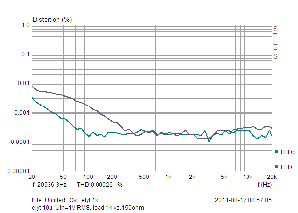

What i did is in picture. I do not know, if test was "to easy", but for sure was realistic if one wants to use capacitor as coupling, to remove some DC ofset in non power stages. And used capacitor(s) is one fom batch of 1000 pcs, price about 2c. Ordinary radial 10u/50V. Measured was THD (spectra), no DA or so..If you did what you stated, then you either had a very good cap, or the cap was not 'working' within the bandwidth that you measured, or the test was too 'easy'. This can be shown with Walt's and my paper where I tested a 10uF ? aluminum cap against an 8uF ? Rel. polypropylene with a nominal 50K load. I got, (best case) 0.19% or about -54dB. This is with just ONE CAP! And by canceling any ideal or static characteristics of the cap on test.

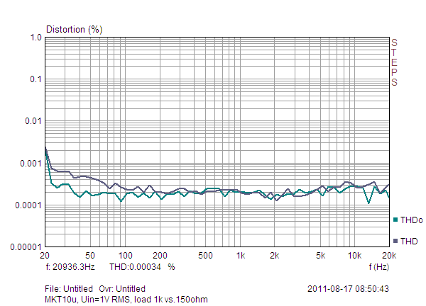

In diference test was this elyt (in+in chain) compared to 10u MKT cpacitor (in -in chain).

What I did (difference test)is here, http://www.diyaudio.com/forums/anal...ch-preamplifier-part-ii-1503.html#post2673998,
results in post before. DA will show (as THD) only if here is some voltage across capacitor, as is obvious from following pictures. No errors, real results, coresponding to well known facts.

"capacitor will generate distortion if here is AC voltage dropped across..." And V test was 3V RMS, load 680 ohm, so. This is the same result, as I posted, no difference.
Conclusion is simple, we should use "big enough" value for coupling capacitor, and we can forget distortions added by capacitor in this position. Using e. g. ceramic capacitor in LP filter (exposed to full AC swing)is something quite different.
