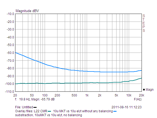

10u MKTcap vs. 10u elyt, without any balancig. Lower graph is my measurement limit. Same results with noise or swept sine. Many amps will be 20dB worse (in/out comparation)..I don't think that a simple difference test will tell us much, either.
Just look at the results of a SINGLE capacitor, compared to a higher quality capacitor, such as a 1uF Teflon in the test that Walt Jung and I did, back in 1985 or so.
A single Mylar cap could give you a -70dB residual, even with compensation for inductance, resistive ESR, and value differences. How can a complete power amp, especially with input coupling caps do any better?

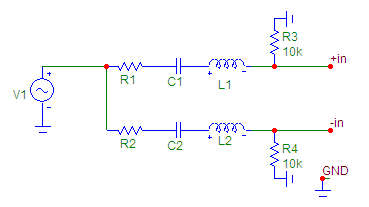

BV, can you share the test set up with us? You show -100dB on the good quality cap, but I would expect something much lower than that. Are your results limited by the source oscillator? I am also surpised by you elco result given the kind on numbers Doug Self shows in his book 'Small Signal audio Design'
Bonsai, used set up is in attached picture . The same signal (swep sine, noise, music..) in two capacitors under comparison, conected to balanced input (+In, -In ,GND) of quality soundcard (Lynx L22, R3, R4 is input impedance of soundcard)). Lover trace in picture in my previous post is CMRR limit of my soundcard (the same signal with 0dBV conected to both +In , -In inputs, shorted together), upper show unbalance influence caused by different transfer in both signal paths.

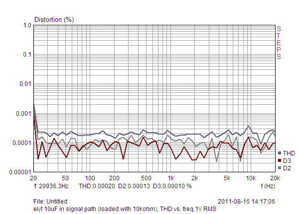

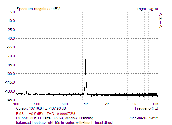

Bonsai, if You are talking about capacitor THD, posted graphs have nothing to do with THD. It is in attached pictures (THD vs . freq. limited by soundcard resolution at fs 192kHz).You show -100dB on the good quality cap, but I would expect something much lower than that. Are your results limited by the source oscillator?

We have found that even a single Mylar cap cannot be nulled to beyond -60dB, using a bandwidth limited asymmetrical pulse with a 20ms (for example) length, and a bit of time left for settling. You cannot use a sine wave sweep of any kind to see this, but MUSIC will have enough dynamic asymmetry to show it.
I have measured about 5% or -45dB with a typical aluminum electrolytic capacitor with the same test, hundreds of times. Anyone can duplicate Walt's, Scott's and my efforts by re-running our test. Just go to Walt's website and get the paper. Remember everyone, this is for a SINGLE capacitor, compensated for inductance, resistive ESR and measured value. This is a measurement of one RC vs another RC, yet we cannot get a good null without an EXOTIC cap.

Mr. Curl, measurements I posted, are for sole capacitor in series with signal (sweep sine, noise, music, asymetric pulse,etc.., results are the same). No active components,so no feedback. Capacitor was conected as coupling capacitor (NOT AS OUTPUT CAPACITOR IN POWER AMP!!!), with reasonable load, so AC voltage across capacitor in whole audio range is negligible. So it is the same then for added distortion (no AC, no distortion), it is negligible. Try to repeate measurements, simply put capacitor in series with signal in loopback in AP system ...Exposing capacitor to whole AC (conected in series with relatively small resistor as "load" at generator output) tels nothing about distortion in "normal" use.
If you did what you stated, then you either had a very good cap, or the cap was not 'working' within the bandwidth that you measured, or the test was too 'easy'. This can be shown with Walt's and my paper where I tested a 10uF aluminum cap against an 8uF Rel. polypropylene with a nominal 50K load. I got, (best case) 0.19% or about -54dB. This is with just ONE CAP! And by canceling any ideal or static characteristics of the cap on test.
