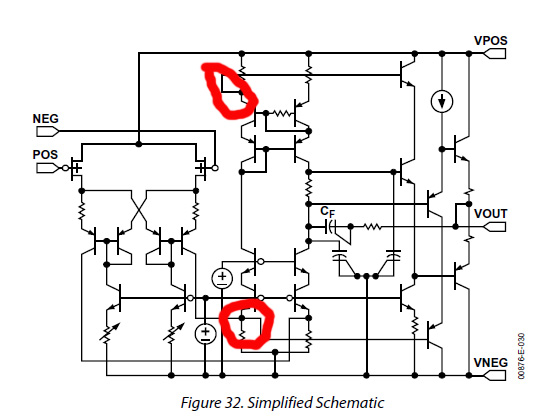

I just noticed that I can use the AD825 to show what I meant. Circled in red are the points where some base current is injected back into the input stage (just like an offset trim) to cancel some OLG loss due to OS loading. Now if you tweak it just right you can make Aol 120dB rather than 76dB or even overcompensate it to be negative. You get any OL corner you want 1Hz, 1kHz, etc. The crossover frequency stays the same at 41MHz. Yes, NADA.

PMA, I have no idea. Why don't you find out for yourself? However, Barrie Gilbert is right, you should read his article, if you have not already.
Hi John,
Barrie Gilbert is right, and his papers are always good reading. However, he does not state that open-loop bandwidth is important for fidelity. He's right, but what he says does not support your position.

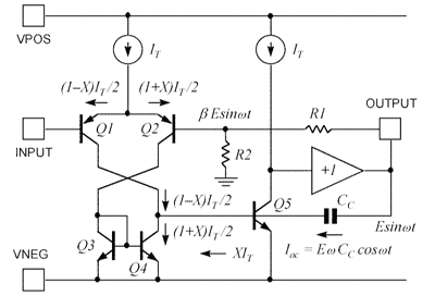

Barrie Gilbert's article supports the 'fact' that a low open loop bandwidth allows 'conversion' of AM to FM, at least that is how I read it.
Actually, I think that *may* be PM or FM to AM conversion, not the other way around.

It is important to read Barrie Gilbert's article to make good sense of it. It is called: 'Are Op Amps Really Linear?
It appears that when you modulate the open loop gain with normal [AM] distortion, you move the effective bandwidth back and forth, creating FM or PM distortion, due to the difference between the working bandwidth and the open loop bandwidth, and the 90 degree phase shift necessarily due to the compensation capacitor. This creates a distortion term that is 90 degrees out of phase with the input signal, and the vectorial summation of the sine (initial waveform) and the cosine (distortion waveform caused by the 90 degree slope) add vectorially and cause a dynamic phase rotation that is directly related to the square of the input signal, and [signal frequency/gain bandwidth]squared.

Yes, but it's only half of the story. It does NOT improve by just making the OL BW higher. It ONLY improves if you increase the available OL gain at the frequencies where the modulation would appear. That decreases the AM distortion and decreases the AM-FM conversion.
That usually means higher OL gain overall and not necessarily a higher bandwidth. Squashing the LF OL gain will give you higher OL BW but doesn't do one iota to alleviate this issue.
Saying that a higher OL BW is required to decrease PIM is incorrect and misleading.
