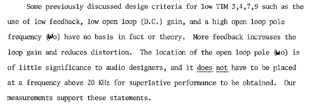

Well that's funny. In his AES paper, Walt says:
(I'll write it out in case you have issues with my attachments)
"Some previously discussed design criteria for low TIM, such as the use of low feedback, low open loop (D.C.) gain, and a high open loop gain frequency (W0) have no basis in fact or theory. More feedback increases the loop gain and decreases distortion. The location of the open loop pole (W0) is of little significance to audio designers, and it does not (his underline) have to be placed at a frequency above 20kHz for superlative performance to be obtained. Our measurements support these statements."
Do you agree with Walt?

I hope that Walt might join our discussion, as he time after time does, and place his opinion on necessity of high openloop wo, without 'translation' by someone else. I do not mean your citation, Jan.
Pavel, I reread the paper in your link, which I also have in my library. I have most of Walt's papers, as they always have good information that has practical use.
This paper however could have been clearer.
Walt is of course correct that amplifiers with higher open loop gain are better than lower open loop gain, all else being the same. Problem is, all else is not the same.

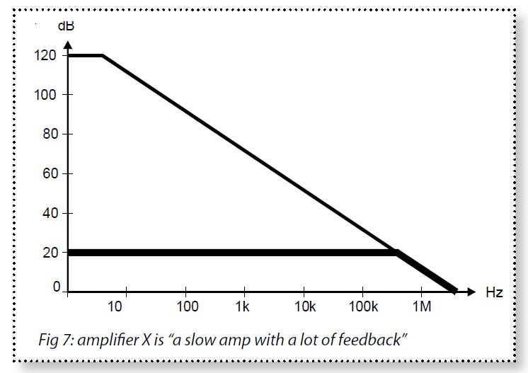

See attached, which shows (top) the OL freq response of an opamp with an OL corner of about 10Hz. I think we all agree that qualifies as 'low OL bw'. There would be little discussion that with increasing freq, the feedback becomes less effective, the error signal increases and if you get into the curved part of the input stage Gm, you may get PIM. Not good.
So, let's fix it: we put a resistor from the Vas output to ground and presto: we have the bottom curve which is a VERY wide OL bandwidth opamp.
Unfortunately, this doesn't help us AT ALL. Remember, the PIM results from Gm modulation due to the high error signal at the LTP input. With our 'fix', we only INCREASED the error voltage at lower frequencies, and DID NOT DECREASE the error signal level at higher frequencies. So our fix results in: a) a nicer, flatter OL response, and b) more distortion and more non-linearity, including PIM, at the output.
Is that what we want? Just cosmetics, and to hell with the performance?
