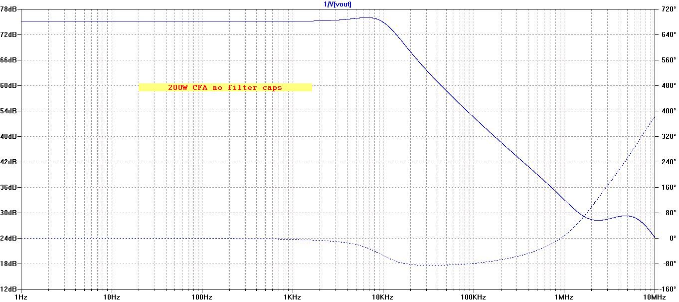

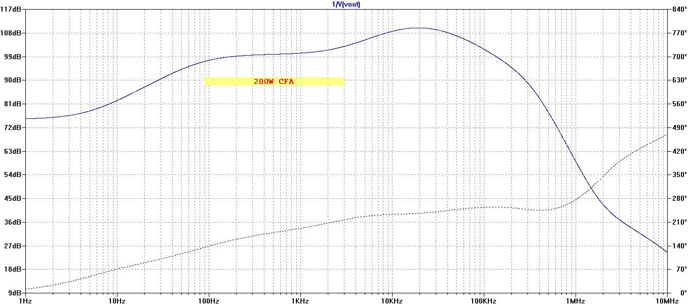

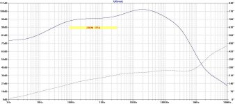

This whole question came about during the VFA vs CFA discussion about what are the differences. It was pointed out how 'inferior' the psrr is of the CFA compared to VFA (high gnfb). As JC and myself and others have noted more than once, it doesnt really matter a lot if you have super high PSRR. You can get the desired end result several ways.
THx-RNMarsh
Richard, this is PSRR of the 200W CFA. I don't see to big difference from VFA.
Damir
95dB at 50/60Hz and greater to over 100KHz. Those numbers from a CFA should put the PSRR debate to rest for CFA. It will work very well IMO.
