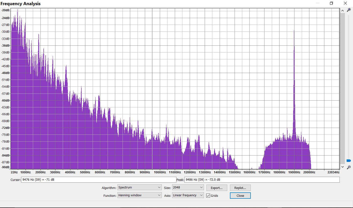

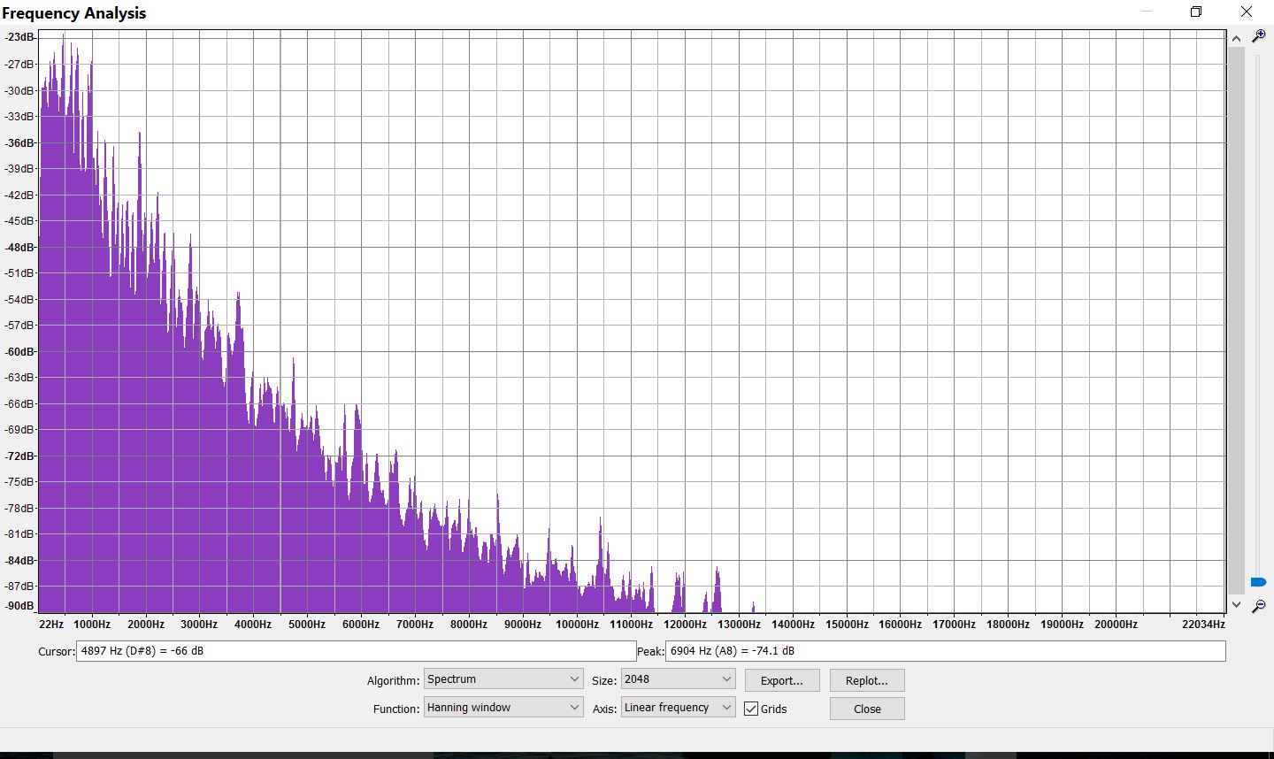

Mention of FM radio crops up in this thread now and again and although in the UK we have had DAB (Digital Audio Broadcasting) for many years I thought it would be fun to try an old Sony ST515L tuner that is around 40 yrs old vs DAB.
Thoughts of vinyl vs CD came to mind
I switched to DAB around 10+ years ago but thought a revisit of the old vs new might be instructive. I've recorded two 3 minute clips both of which have the same content. One is FM and one DAB. Both are clearly marked in the file name. The DAB version is UK digital at its finest and highest bit rate I'll not tell you what that is yet, but suffice to say that this is as good as it gets. Many stations are on much lower bitrates, some very very much lower.
If anyone is interested I've put the audio file on Dropbox which is linked to at the end of this post (go on, have a listen). They are only 320kbs MP3's so no big downloads.
Have to that I'm slightly surprised at just how good the ancient and original Sony actually is. Unfortunately I haven't an outdoor FM aerial, just a loft job. Its not so bad though.
One of the two seems to have a much wider soundstage than the other.
The digital tuner is a dedicated 'high end' offering. A Pure DRX701ES.
Also shown here is the spectrum of both. No guess for which is which. And what's that spike at the end of one of them I used to be able to hear that once... from this very tuner.
Spectra
And here is the audio. Its a zipped folder containing one DAB file and one FM file. Both are MP3's
Mooly you mean: can you here the 19kHz stereo pilot?
I am surprised it is in the spectrum at all. Wouldn't the MPX filter be expected to make short shrift of that??
FM is supposed to be sharp filtered at 15kHz.
