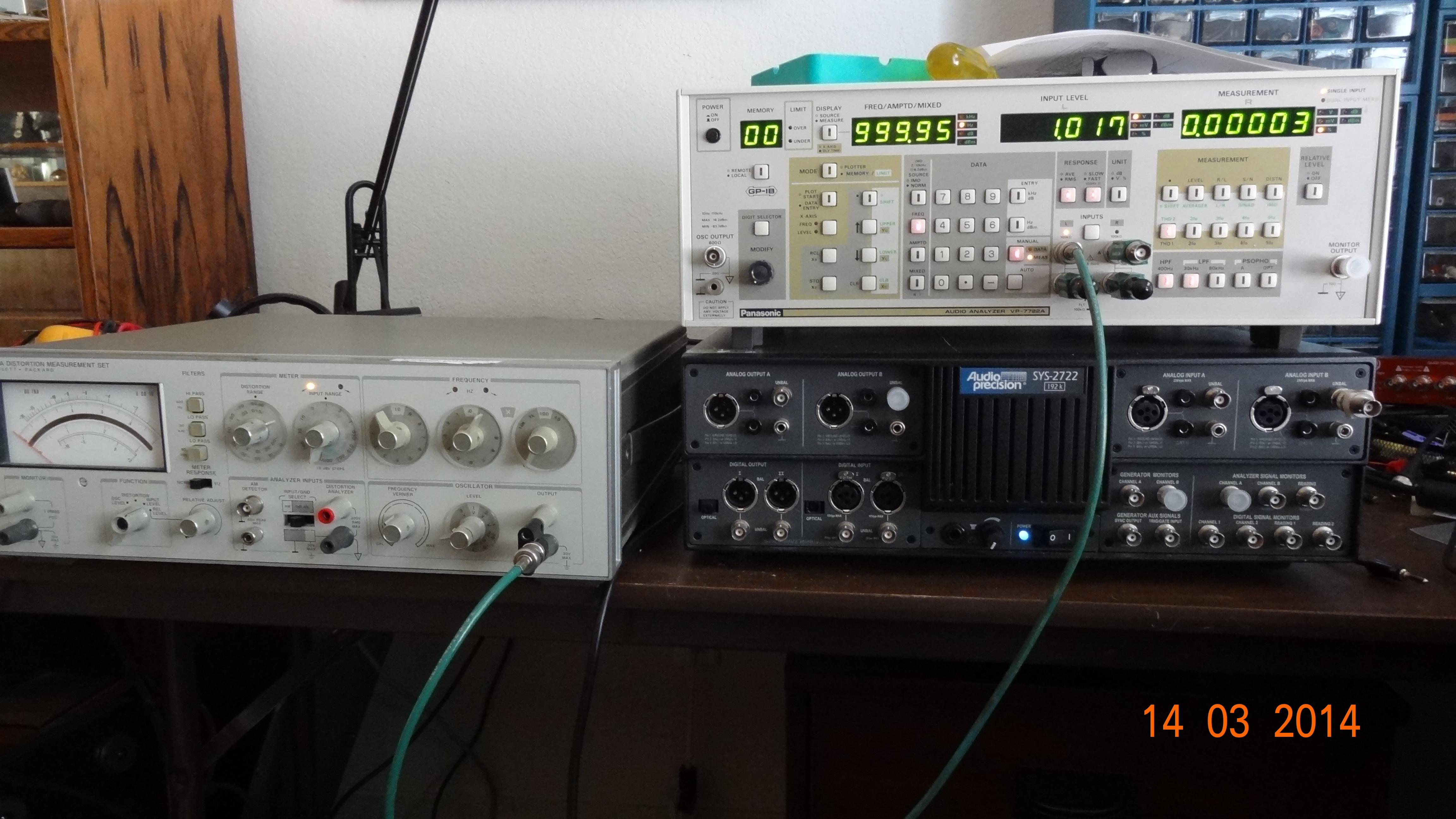

Looking at the actual oscillator schematic of the HP339, I cam see where the AD797 is not the best fit. You apparently have to avoid some circuit configurations, because the AD797, as good as it is generally, has input impedance issues. Scott, this is called upgrading, not re-design. We can't tear apart the HP339 completely to make your IC work optimally. Other IC's apparently work better in this circuit. Was that the LT part, Richard that you found worked best?
An oscillator that presents common mode voltage to the op-amp is compromised we have moved on from there. As for verifying performance at these levels we found moving leads around or changing benches i.e. everything mattered.

Thanks John. [my internet was down last several hours] As you all know, the upgrade on the 339A was not a redesign but what could we do to make it better. later, david (davada) started his own design from scratch and it is extremely low distortion and Variable freq as well (not spot freqs).... and fast response time at low freqs. The work can be followed in the test equipment forum. SG has a great performing osc/gen also there. A rather complex design -- pcb will be avail.
I am Not interested in how to make the 797 work in any particular app. I have read the huge effort by SG in his opamp tests a few years ago. Not recently. Just want information or explanation which may be useful later or to others here. I like that people are starting to get involved and ask better questions of their own. Jitter too.
The LM device which worked so well is in the 339 upgrade section.... I dont recall it now off the top of my head. I might look for it later and let you know. it wasnt the last word in noise though.
Thx-RNMarsh
I have had the same endless experience when looking below the -100 dB mark. What they did in the LIGO must be heroic to keep all the gremlins out.
