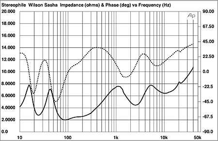

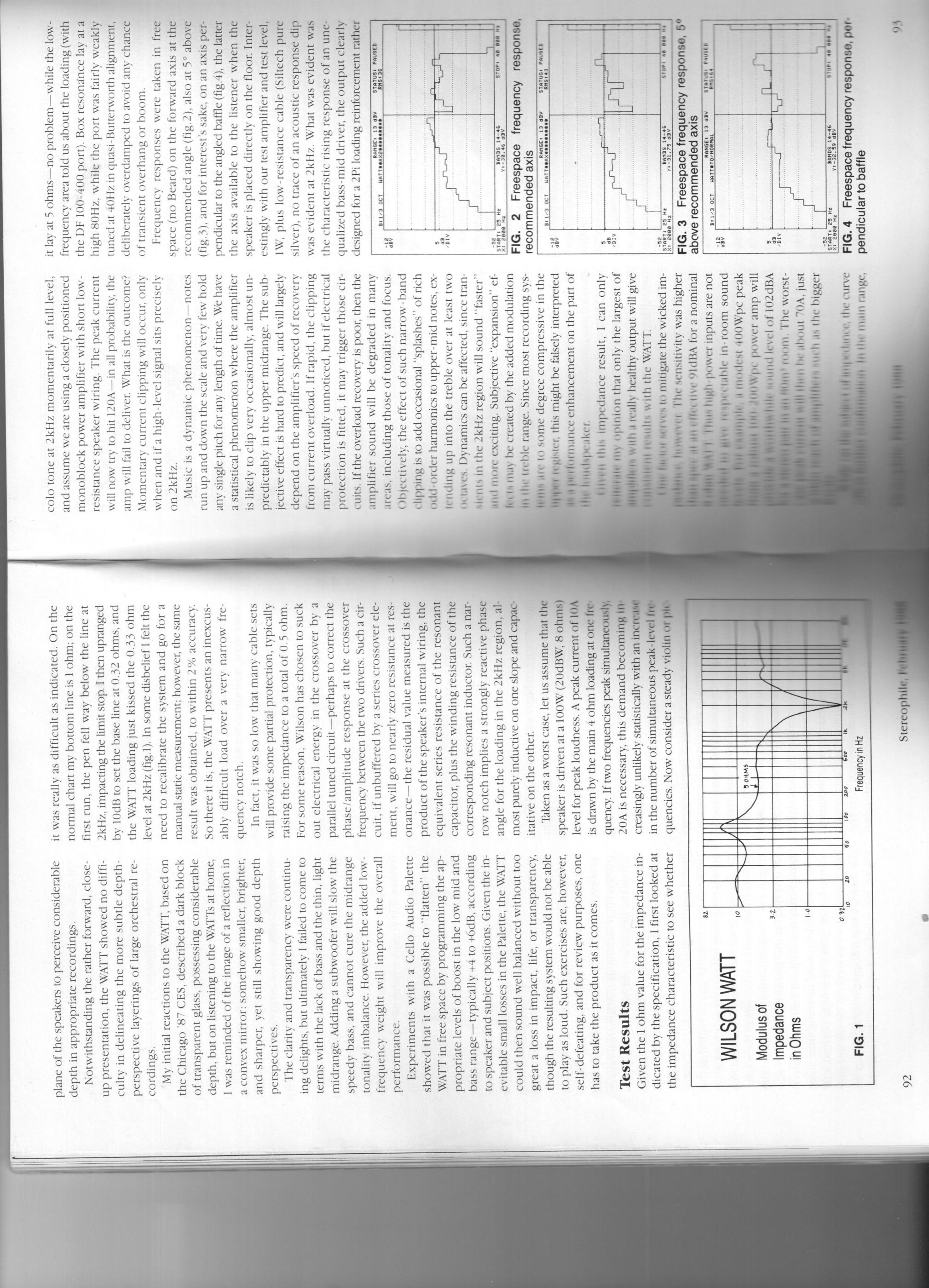

As a designer of amplifiers, I cannot dictate to the customer what loudspeaker or combination of loudspeakers they might use, so I have to design for 'reasonable worst case'. I think that many here forget that, because 'their' loudspeaker load is a relatively easy drive. I too have such speakers in service, daily, but I still have to drive the difficult speakers as well.
Back around the late 1980's, I was given a set of WATT-Puppy 1 loudspeakers to replace my Rogers with a subwoofer. I therefore was GIVEN this difficult load to drive with what I had available. I wasn't working for Parasound then so I made do with an Electrocompaniet. It worked OK. Now WHY did it work OK?
Because it did NOT have a sophisticated E-I amp protection network that might have fired regularly and upset the sound. Just good luck to use that amp, I guess.

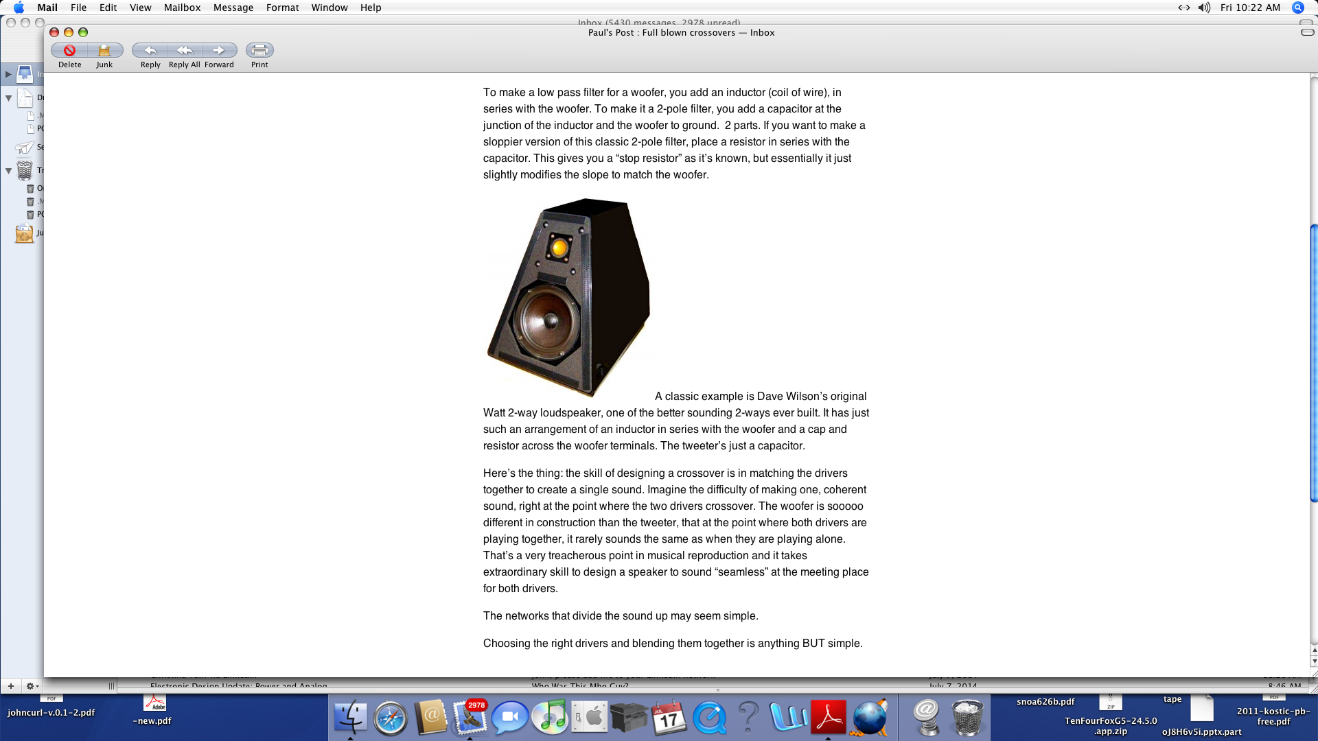

Now where did the problem with the WATT1 come from? There apparently is a series resonant circuit connected between the tweeter and ground that omitted sufficient R to keep from looking like a virtual short circuit at 2KHz. This was a design mistake, made by Dave Wilson, who looked at the measurements of the actual acoustic output, and not the impedance, and he used Krell amps that could drive this difficult load successfully. Had he tried a Japanese amp similar to what you guys seem to like, he would have known something was wrong. I have told Dave this, so he knows. No designer is perfect, but I personally found that the WATT was one of the best sounding speakers in the world, bar none, because Dave put a great deal of care into the design, especially the construction of the speaker cabinet.
Today, I use a Wilson SASHA, and while it is bigger, stronger, and more impressive, I still fondly remember the WATT1. Here is the comparison between the WATT1 and the SASHA impedance curves. Still a difficult drive.
