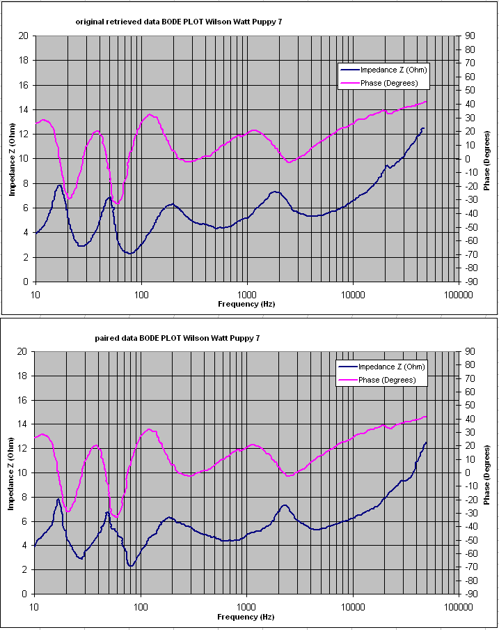

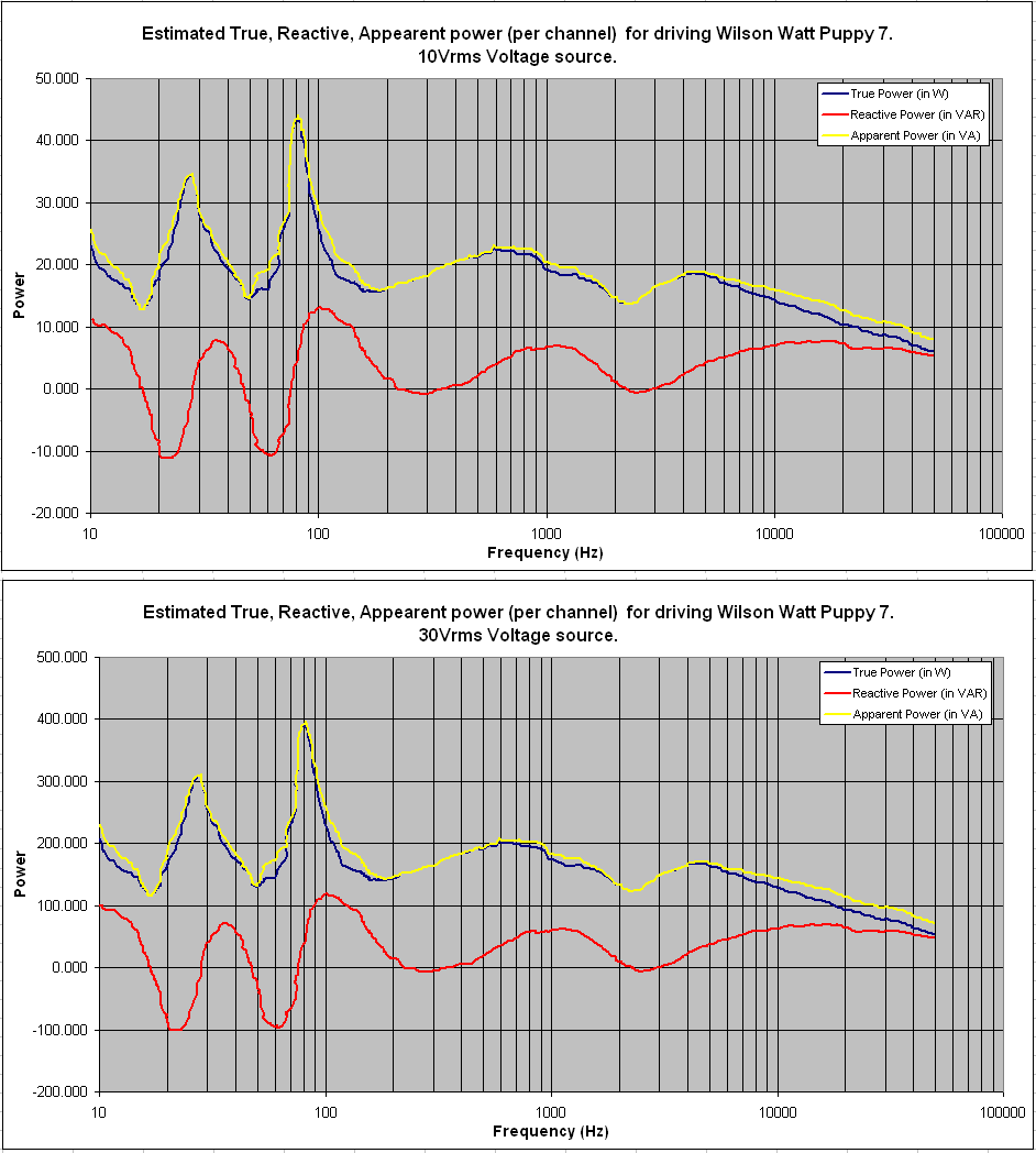

This is an estimation based on the impedance of Watt / Puppy 7 as published by Stereophile
Wilson Audio Specialties WATT/Puppy 7 loudspeaker Measurements | Stereophile.com
I digitized the data using Digitize graphical data with Dagra
Then I spent some hours doing data pairing and then had Excel perform the calculations

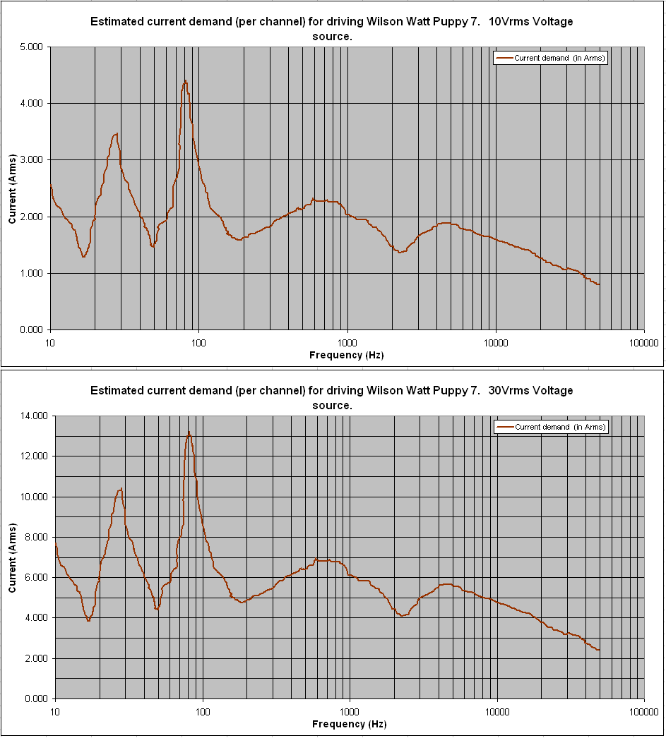

According to published sensitivity of 93dB/W/m, 10V rms drive (~25W) would correspond to approx ~96dB spl (midrange I guess) at 5 m with two loudspeakers playing.
For 10 dB spl more (doubling the sense of volume), the drive would need to be approx 30Vrms (~225W)
