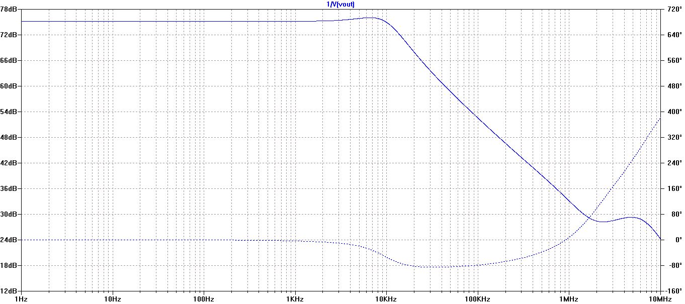

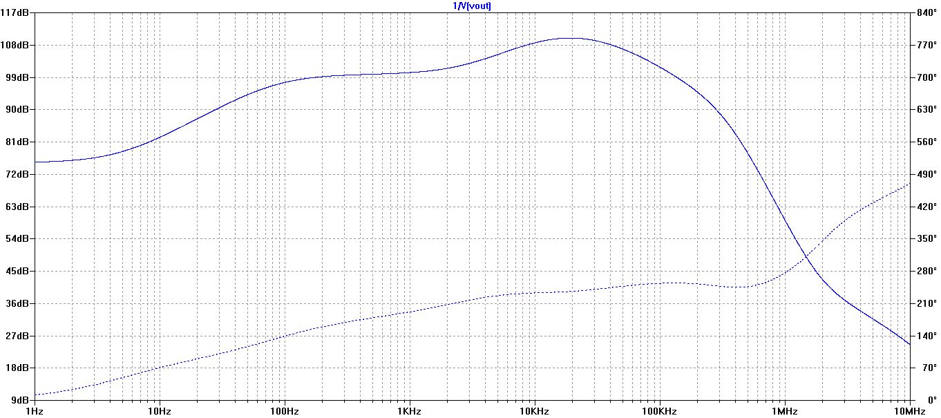

The re-question is --- Not what arb figure to design psrr to..... rather what is the min needed to be designed to given typical PS used for PA in order to be inaudible in typical system?
This is in the interest of some topologies having inherently lower power rejection than others.... VFA vs CFA. And, does that inherently lower number really matter if it is sufficiently high. What is sufficiently high, listening-wise?
THx-RNMarsh
Is this sufficiently high enough, listening-wise, and this is CFA?

For CFA, cap multiplier (CM) + high loop gain = high PSRR
The CM confers at least another 30~40 dB PSRR. I have some photos in my e-Amp write up with scope shots before and after the CM that demonstrate this.

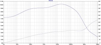

No cap multipliers in that CFA whose PSRR I presented, just RC filtering for the IPS.
This is PSRR with no power filter caps at all.

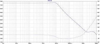

I put here the Loop Gain plot and PSRR plot of the same amp showed before with all power filter caps removed (not of course for the LG plot).
It is interesting to see how the PSRR plot refleks the Loop Gain plot.
