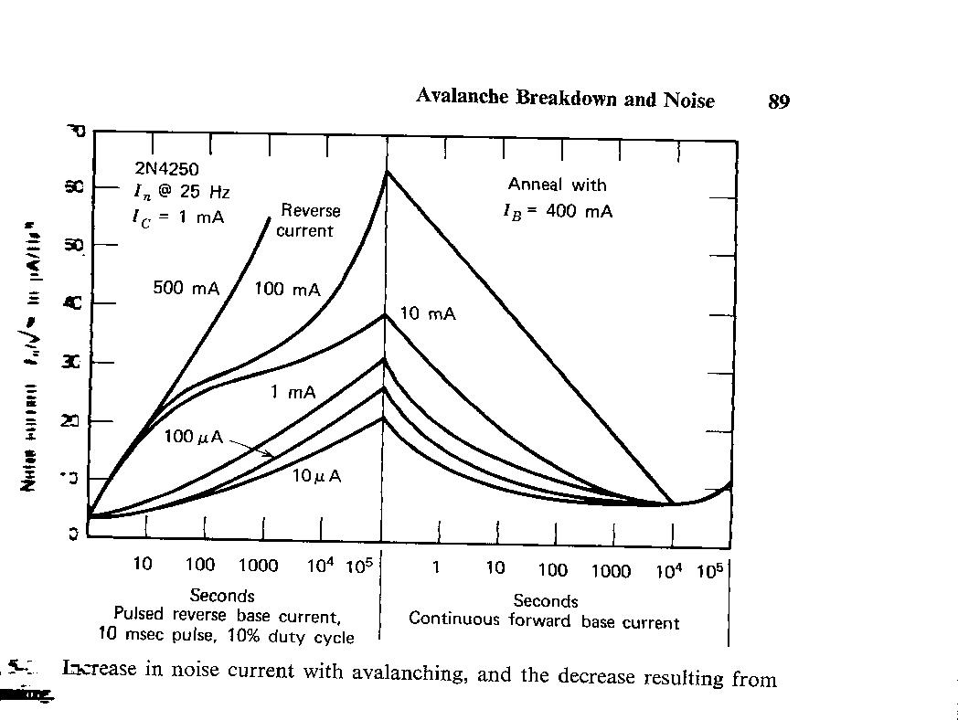

Yes, it is a serious degradation mechanism. Motchenbatcher cautions about testing low noise bipolars with an ohmmeter in his first book. He also mentions that the damage done can be annealed out by high temperature baking, although this is scarcely practical!
Are there details on what transistors specifically he had tested and what the meter did to fry them? What current it takes?
IIRC Scott mentioned one way to reverse it was to apply high base current?
Not me, avalanching Vbe's creates hot carriers that get trapped in the oxide there is no guaranteed way to perfectly reverse the process. Everything I have seen is empirical type stuff. In general high temp annealing for a while probably gets everything to relax back to normal, I don't know if this has been extensively studied.
Without further brutalization of the book, or a decent document camera, I can't get satisfactory scans of all the several pages, but here is the beginning of the discussion and the first figure. These are from the first book by Motchenbacher and Fitchin, Low-Noise Electronic Design, ISBN 0471619507. A second similar book with Connelly is around somewhere but I don't recall if the same discussion is in it.
Yes, the section reports that the annealing was done by running 400mA of forward base current through the device, and that, although of interest, is not a practical solution :)
PS: a paper by McDonald is referenced which may have more details about the degradation and restoration, Avalanche-Induced 1/f Noise in Bipolar Transistors, IEEE Trans. Electron Devices, ED17, pp. 134-136.
