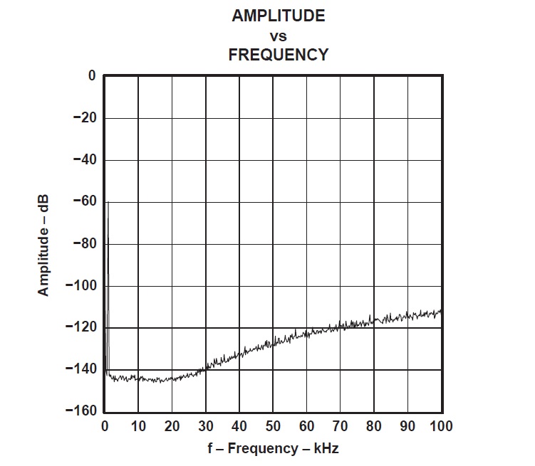

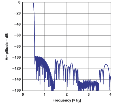

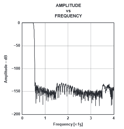

wrt DACs: it's pretty much a matter of getting what you're paying for. The datasheets make no mystery of the HF noise.
PCM5102 (cheap)
PCM1798 (middle of the road)
PCM1794 (best)
wrt ADC: you clearly have boatloads of noise. Before jumping to conclusions, it would be interesting to identify the source of that noise. Only you can do it, it might be specific to your setup.
PCM5102 (cheap)
PCM1794 (best)
It seems that only the most expensive and with well designed support circuitry etal produces what you would expect to see in practice. I have the best spec numbers ADC and DAC around (BenchMark's newest).

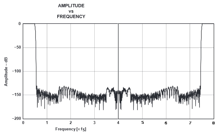

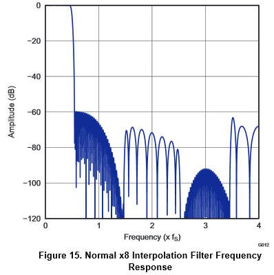

PCM5102 (cheap)
PCM1794 (best)
These graphs show only internal (to the DAC) oversampling digital filter stop-band performance in digital domain. And only up to the 4x Fs (!) They do not show what happens at 8xFs or what comes out of D/A portion of the chips.
The real situation is more like this. First image is manipulated by me, the second one is from the last page of the PCM1794 data sheet. Note the signal amplitude at 8x Fs in the first one and raising noise floor in the second that looks just like in Richard's measurements.
