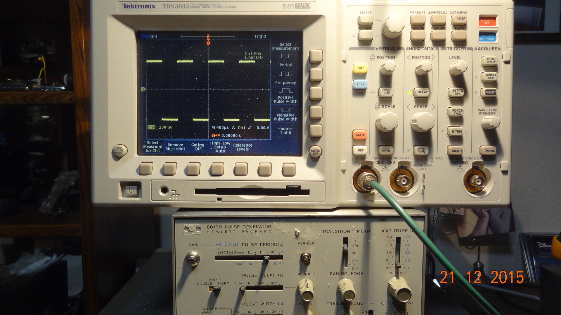

This is a 1KHz square wave recorded

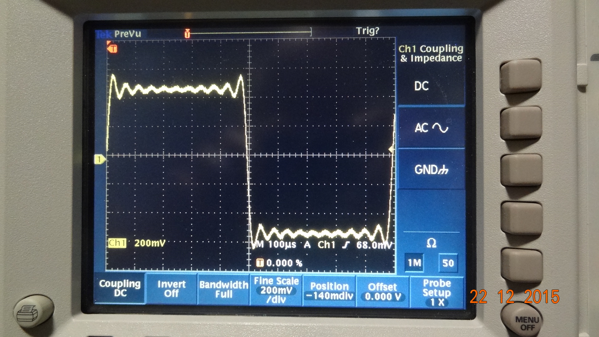

And, played back on same machine at analog output.
Why do we allow this? We wouldnt if it was an analog instrument/amp.
The added filter LPF (passive LCR) helped reduce this ripple/ringing level.

Richard, I believe (and i believe you know-it) that is is not "ripple/ringing", but just a square wave signal with higher harmonics totally and abruptly removed.The added filter LPF (passive LCR) helped reduce this ripple/ringing.
The 'ripple or ringing' - like- new added signal is described from traditional analog view. It is from the ripple of the sharp cut-off LPF (20KHz) design. Better filters with much lower ripple level beyond cut-off and still not introduce audible group delay is needed. Dont know if that Must cost more.

Or the simple fact that plus to minus full scale in one sample period could not have been created by a process that obeys Nyquist, it's simply made up by the computer.
It is typical from oversampling and digital filters. A brick wall upon half the sampling frequency.The 'ripple or ringing' - like- new added signal is described from traditional analog view.
You can get the same by pure calculations.
The "ripple" (witch is not) is out of the audio range and this signal a clear demonstration of situations where slew-rate and bandwidth are not correclated any more in some digitaly processed signals. Reason why we want high slew rate amplifiers, with analog HF input filters, limiting the slew rate.
