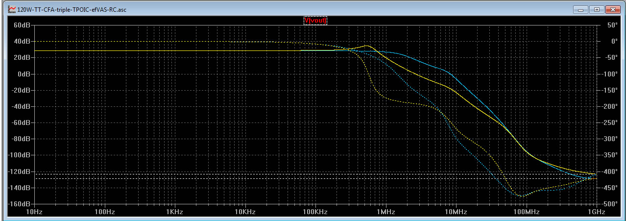

dadod, your feedback ratio begin to decrease at 1KHz. No surpise you don't see any difference with feedback impedance.
Everything was explained about this simulations in my previous posts.
My purpose was not to criticize your design, but to help-you to understand what a CFA is.
Unless you achieve to add stages faster enough to introduce no openloop bandwidth reduction, you cannot do-it. CFA are in the spirit of Kartings, you cannot design them like a limousine (VFA way of thinking).
With the actual available device's speed on the shelf, you need to get a flat openloop bandwidth up to 10KHz. That is the goal. After this, you can try to add complexity in order to reduce distortions, taking care to not destroy original speed, or adding unwanted poles, not good for stability.

Not to mention it is so easy to reach this stupid "design goal". Just load the VAS/TIS with a resistor and one can trade loop gain for open loop bandwidth.
Just as easy as it is to add a little DC Vos positive feedback to make almost any amp 120dB Aol at DC. Even the Otala amp, a very large resistor from the output to the appropriate point and suddenly the low OLBW goes away.
Sorry Esperado, I am talking about something you don't understand so we are done here
Sorry, dadod, YOU don't understand what is a CFA. and your amp demonstrate-it*. I have still a lot of questions about them, but I work on this topology since 1970**. And you ?
* I don't say it will sound bad, do not confuse.
** With the same errors at the begining.
Or use a local NFB around VAS/TIS, but in my CFA I don't do anything of this and have flat loop gain of around 80 dB up to 20 kHz(or open loop gain of 108 dB). All this with the proper compensation, and that is the amp Richard is saying it sounds so good.

dadod, it seems you didn't understood my attempt. Neither try to understand what I said about my way to explore-it.
I was not criticizing your amp and don't want-you to be crossed against me.
I was just trying to explain why you don't see any difference with high or low impedance of your feedback path: your bandwidth is not high enough to see-it.
And you asked the question.
Your amp is a VFA with a IPS topology of a CFA. Nothing wrong as long as it sound good, but is is like this.

One day, when I'll have the time to put it together, I'll show you a 2 pole compensated VFA (in fact, a slightly modified Lin topology) with the same high ULGF as yours and the same 80dB loop gain at 20KHz. Perhaps that will be the proof you need to understand there's nothing really special in your so-called CFA. Not the same SR, of course, but still 20x of what's required to avoid TIM.
I couldn't care less of Mr. Marsh's (or anybody else) CFA SQ comments, as long as they can't prove they can tell a VFA from a CFA in a DBT. Until then, the sacred cow is naked.
Dadod, I just simultated your amp with 5500/220 (Yellow) And 550/22.(blue) in your feedback.
How can-you say feedback impedance has no influence ?
