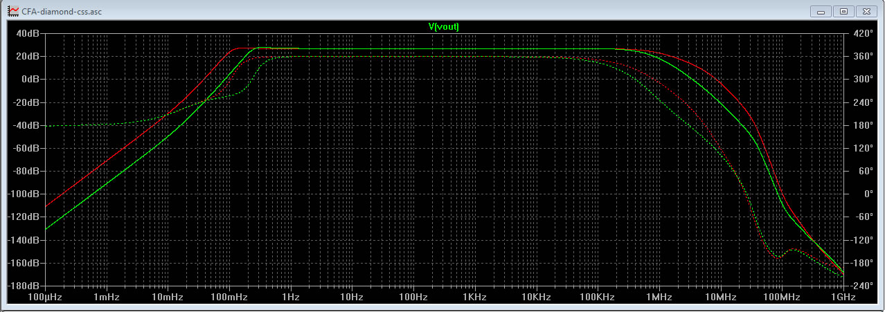

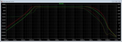

Looks strange to me. Attached, a quick'n dirty test with my Diamond VSSA, just multiplying by 10 the feedback imedance. Red is original (500) green modifiéed (5000).I have tried this amp for different reason, but was a bit surprised that it behaves the same as the one with low impedance emitter input.
It is at the limit of the margin I usually keep (5 or 10)
You can be sure that distortion will increase too, because the parasitic caps are not linear.

You can't compare VSSA amp with it. I added V/A converter as high impedance input(or how Bonsai called it H- bridged but not exactly just looks as one), it is not just change of feedback network impedance, take a look again at my schematic.
If it is this: http://www.diyaudio.com/forums/solid-state/253039-unique-cfa-120-230w-amp-8.html#post4428619You can't compare VSSA amp with it. I added V/A converter as high impedance input(or how Bonsai called it H- bridged but not exactly just looks as one), it is not just change of feedback network impedance, take a look again at my schematic.
I don't even need to look at the schematic. Bandwitch is limited elsewere at 100Khz, so, no surprize you see no change at 5-10MHz ;-).
Well, you need, at least, to remove the input filter, while looking at those parasitic caps issues and compensate the amp for max (but flat) bandwidth. The spirit of CFA design is: "Fight for speed".
But the new analyzers don't require that filter anymore. Except, with the fairly recent Levinson amps, the relatively-low out-of-band energy extends to at least 4MHz, according to what I've heard. Back to the drawing board? Or just a kinder gentler higher-frequency filter box?
Of course this has almost nothing to do with slew rate.

If you don't look you don't see, look second picture. Why I need to to remove input LF filter, I am showing a Loop Gain not Closed Loop Gain as you showed of your VSSA? Input LF filter has very little influence on the Loop Gain.
Yes, give-me some time to read further in your thread I just discover.I am showing a Loop Gain not Closed Loop Gain as you showed of your VSSA?

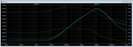

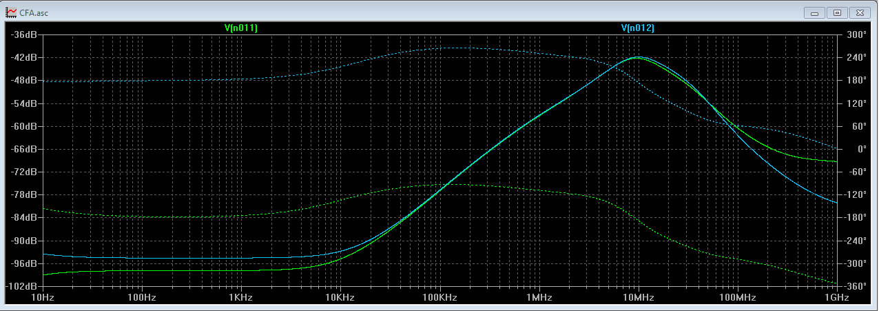

I sometimes had serious doubts about the validity of Plotting Loop Gain Using the Tian Method.
I prefer to make an AC Analysis at the output of the input stage or input of the VAS (right after signal of the feedback had been subtracted from the input one).
It shows a flat response curve that begins to increase when you reach the limit of the open loop bandwidth, then decrease when you reach the limits of closed loop bandwidth, in real closed loop condition.
An other advantage: you can compare in the same window the two branches of a symmetrical design and figure out any unbalance. Instant, painless and easy, no prob to add to your ASC.
Without the loop gain plot you just blind, you can see some anomalies in close loop gain, but those anomalies are better visible in the loop gain. Off course you can place the Tian probe inside where you want to see what's going on.

dadod, I'm not sure to have been understud.Off course you can place the Tian probe inside where you want to see what's going on.
NO Tian in my figure. Just AC analysis. When you reach the limit of OLG, the feedback response curve begin to increase (feedback fighting to compensate the losses). So, you see all in once in real conditions and can use-it IRL as well.
And, may-be it will make some people change their minds about this "Need for speed" question ?
