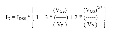

This is much better. + channel length modulation, that depends on Vds.

PMA said:
Oversimplified textbook true. No real part behaves like this.
Excellent, you must be my electron device physics PhD advisor in disguise :rofl: :rofl: :rofl:
Seriously, before copy/pasting and declaring "much better" such, you'd better do your homework and make sure you understand when, where, for what devices and under which circumstances this formula holds.
Anyway, it does not include any channel modulation effect due to the longitudinal field (which is what counts an any device since the 60's) and is simply the result of a series expansion of the atan model that Scott mentioned. For all practical purposes, it isn't in any way shape or form much better than the classic parabolic and Lambda corrected Id=f(Vgs) for any devices currently available.
Here's a comparison between the two approaches.
And BTW, your beloved Spice you used to prove to the world the JFET matching benefits uses exactly the parabolic model with Lambda channel modulation :rofl:
