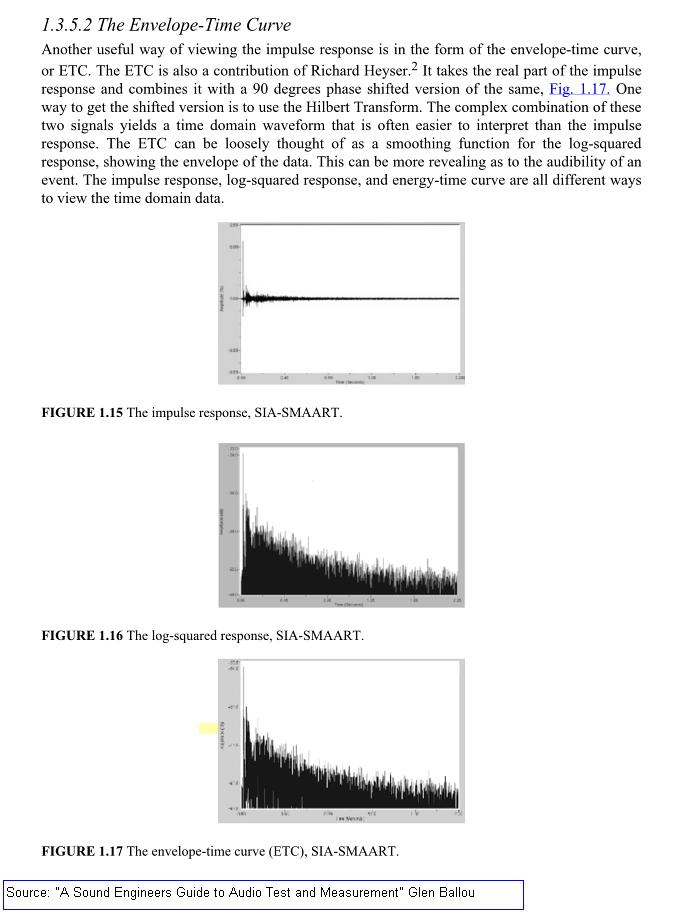

I am at a loss what Excelsior means by 'Envelope Time Curve'. Google's answer is recursive. Is it the envelope of the impuls response? If so, why not look at the impulse response directly to ascertain where the acoustic center of the drivers is. This is the only use for impulse response I can see in the context of driver alignment without further processing.
Heyser’s Envelope Time Curve (ETC) technology resulted in the chance to meaningfully study loudspeaker–room interactions.
I hold Harry Olson of RCA in high regard because, as the editor of the Journal of the Audio Engineering Society in 1969, he found Richard C. Heyser’s original paper in the wastebasket; it had been rejected by means of that society’s inadequate, at that time, peer review system.
Glen Ballou, “Handbook for Sound Engineers” 4th Edition
http://digitalcommons.colum.edu/cgi/viewcontent.cgi?article=1037&context=cadc_heyser_unpublished
TIME DELAY SPECTROMETER
George
