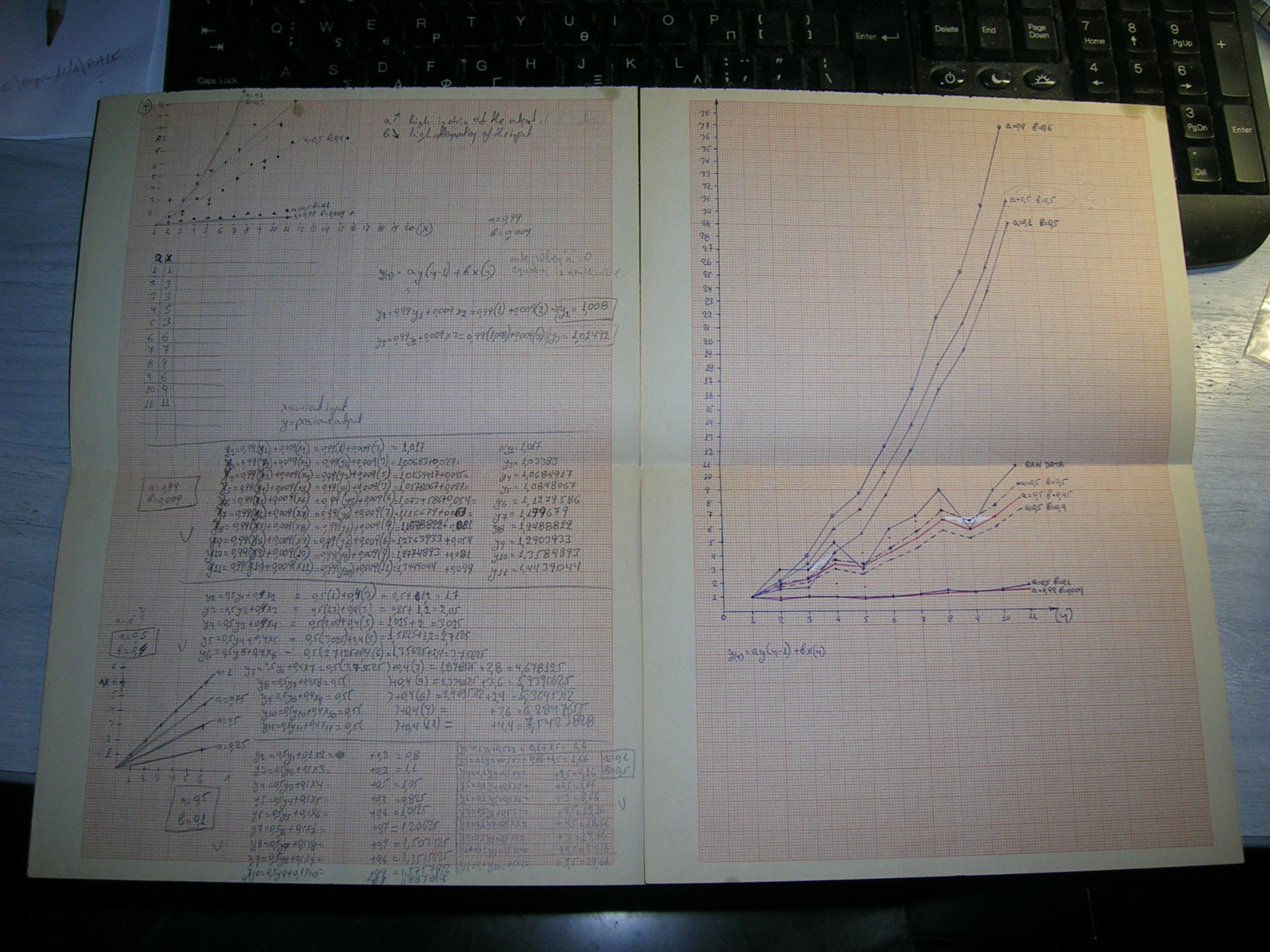

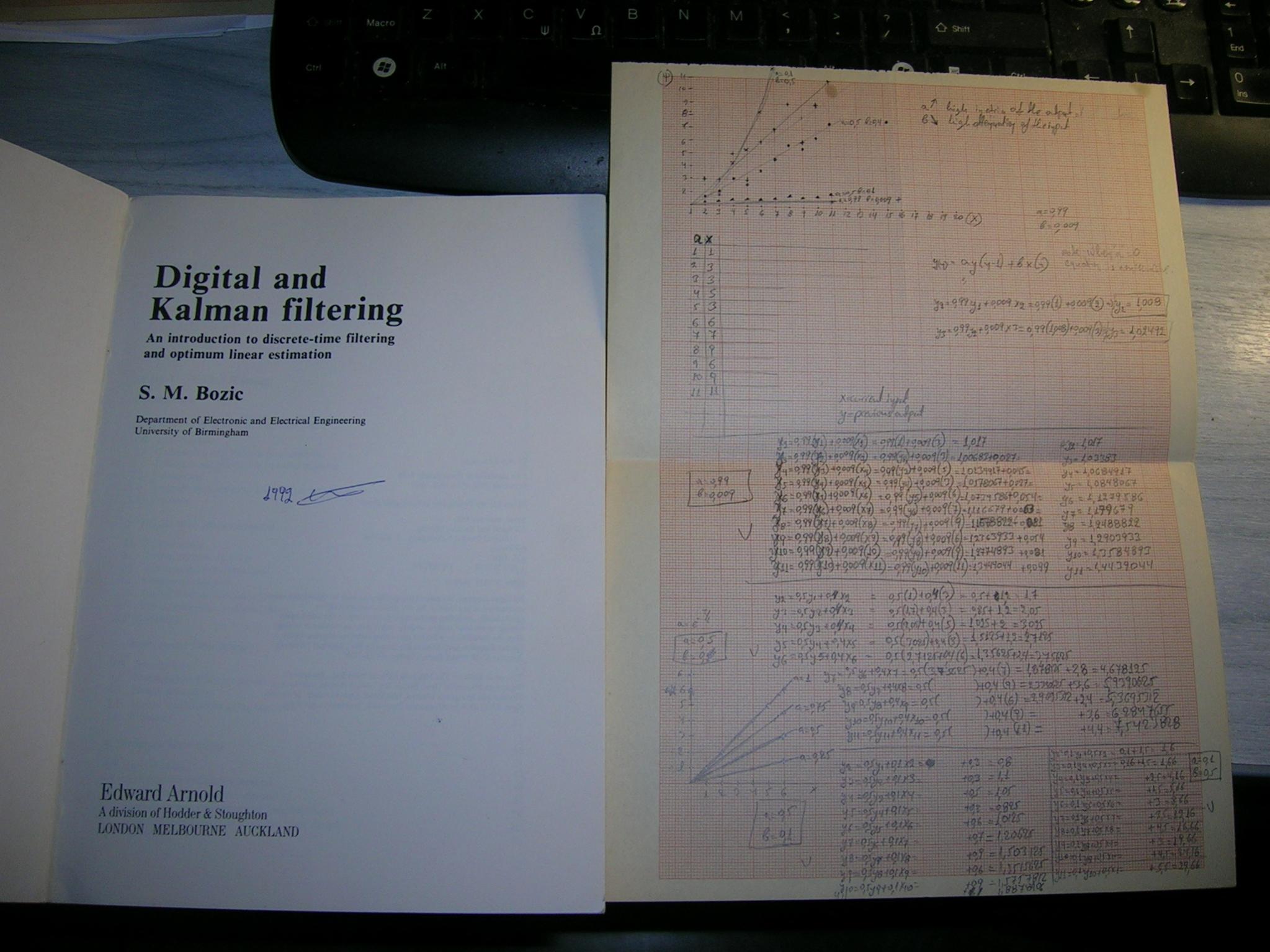

Dan, with recursive systems, the higher the recursive factor, the more the system acts as a low pass filter, consequently rejecting noise.
George
You’ve triggered my queer memory (from the days I was developing a Kalman filter for a friend who was checking the validity of macroeconomics formulae, using a huge data bank)
