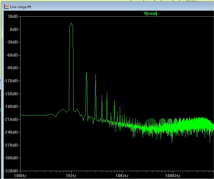

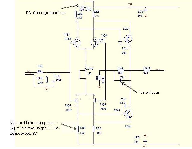

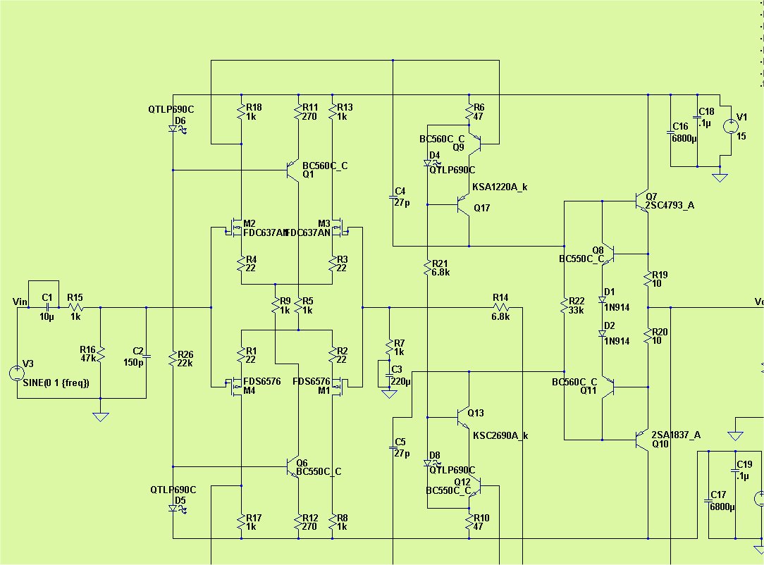

The only matched P/N channel low noise Jfet I could find is U440/441.
Dual monolithic is the only way to go (to keep it simple).
Still ,Jfet's are hard to source ... I tried mosfet P/N pairs. Real good (below) :) .
They are so easy to find - 20 different choices of both P-channel/N-channel
in matched dual SMD.
DIY'ers lose patience when they can't source (or have to buy a hundred
to test/match).
The reason for my latest "kick" here is that my amp far exceeds my
sources now. Must correct this. Many good -115db attenuators (pga2311).
They only drive 600R loads , but with 2ppm/20K. Need a buffer !
Add a DAC , most of the PGA2311 kits have a extra input just for this.
So , DAC/ 3 more inputs (remote control) and a buffer that can drive
any amp (or headphones).
to test/match).

Because of the coin-flip Ben Franklin direction convention for current flow, most like to think of circuits with positive power supplies (as high) and common. This leads to a need for high-side switches most conveniently made from P material and enhanced with gate voltages lower than the switched supply, and as you point out there are a bunch of them now, mostly for low voltage use (the DMOS shown has a 20V Vds max and +/- 8V gate-source limitation). Something to consider if you overdrive the circuit shown---not sure which will "give" first, although gate damage is the worst and irreversible.
It seems as if you are using P/N in two different senses above. The U440 is an N channel dual. So I guess "matched P/N channel low noise Jfet" means matched pair... Then "mosfet P/N pairs" means pairs (of single parts, not duals) of P channel and N channel.
Have you looked at low frequency noise for those DMOS parts? The sheer size may mitigate, and processes continue to improve, so it may not be too bad. Of course the manufacturer provides no noise data.
Does anyone know what happened after the introductory distribution of Linear Integrated Systems' LSJ74? I never tried the one piece I got, as I tend to shy from P channel if I don't really need it, and at that I have a fair stock of Toshiba 2SJ74 and even some of the rare 2SJ109 duals.

That's what I am currently researching. The noise at "X" current. This is
the only reason I am even considering a voltage controlled device instead
of the BCxxx's.
I can still hear the BJT junction noise through my headphones. I beat
the hum , semi noise is the "last frontier".
PS - I can always use gate protection in case of overdrive ??

There are quieter bipolars, at least somewhat, even if the superstars for low rbb' like the 2SA1316 and 2SC3329 are very scarce now.
Yes, the gates of the DMOS can be protected, although most schemes will introduce some variable capacitances and hence a potential additional distortion mechanism. Biasing a zener and using a small PN diode to isolate until the threshold is reached can help.
Exceeding drain-source Vmax magnitudes will still be a possibility, but that would be rare and usually nondestructive---it's the vulnerable gates that will kill one.
