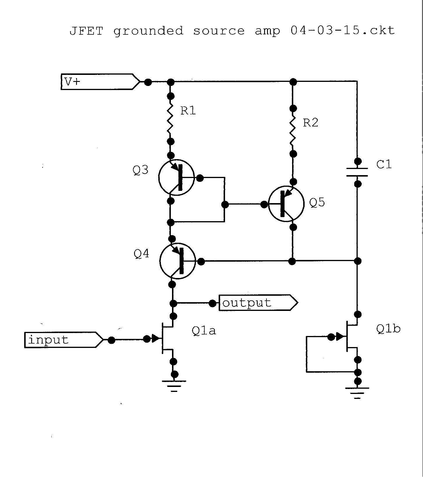

I can't believe there is not one single person here who can recommend a single pakage dual NPN JFET from a reputable source of non-Chinese origin? Or can say where it can be bought?
Of course you mean a dual N-channel JFET.
There is a distributor for Linear Integrated Systems with offices here and there. LIS have their sub for the Toshiba 2SK389, the LSK389. They have a smaller geometry part, the LSK489. Both are available in leaded and SM I believe. And they make a few others: Linear Systems || Products
Toshiba has discontinued all, or nearly all, of their leaded parts, I think. However there is a SOT-23-5 part that is about the same as two 2SK117, the 2SK2145. I don't know who the distributors may be. I don't appreciate that they tied the sources together---a decision by someone who assumes we would only wish to use the pair as a differential pair with no source degeneration. Short-sighted.
Interfet makes some legacy duals, and some exotic large-area parts on special order. LIS and Interfet are US-based. They now mention Mouser is a distributor. InterFET Corp. InterFET

Thanks Patrick, nice to see that Mouser also distributes Toshiba here.
Yes, agree that you can get a source follower out of it readily enough. But it is still inflexible for some configurations I like, including a grounded source amplifier loaded with a matched current-source load, or composite halves of a diff amp that requires independent channels. Or as parts for one of your current conveyors with individual cascoding.
One more pin... At least the parts seem to be dielectrically isolated, so the problem of voltage-dependent substrate capacitance is eliminated.

...But it is still inflexible for some configurations I like, including a grounded source amplifier loaded with a matched current-source load...
Brad
Here is an approach to dealing with the connected channels on the SK2145 and other similar duals. It uses one half of the dual as a current sink which is filtered and mirrored, a Wilson mirror with ballasting for lower noise shown here. Of course one can cascode each JFET for higher gain at the output and reduced Miller capacitance at the circuit input, and the output must be level-shifted, most likely, for succeeding stages. The Wilson mirror can benefit from a final additional bootstrapped cascode as well. Thus one gets a high-gain inverting amplifier with the noise almost as low as a single JFET, with input offset voltage close to zero.
It does require spending some volts, and the stage output is very high impedance.
