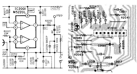

As shown at the schematic and realised by the pcb traces, the output is NC and the inputs are tied to local ground.That is probably the reason... but, might also be used to affect a 'guard' for the other amp?
-RNM
For guarding to be materialised, the output of the now ‘dormant’ op amp should drive a physical guard around the - input of the ‘active’ op amp (but I don’t think that at that position of the circuit guarding would be necessary).
I have a feeling that Dejan will try the paralleling trick
George
Not likely, George.
For purely irrational reasons, I dislike hybrid FET/BJT/op amp circuits and like to stick to pure, so it's either FET/BJT or op amps. The only concession I make is adding discrete current boosters to op amp outputs, tried it several times and liked the results.
I am old fashoned in that way, I like transparent, pure blood setups. It's either beer, or it's ouzo, I don't mix.
Also, strange as it may sound, I haven't had an opportunity to try out the Luxman's RIAA section yet. Obviously, I will do nothing until I can first try out what I already have, once the turmoil at home has ended and I get those builders out. Unless I kill one or more of them, which is a distinct possibility at this time.
