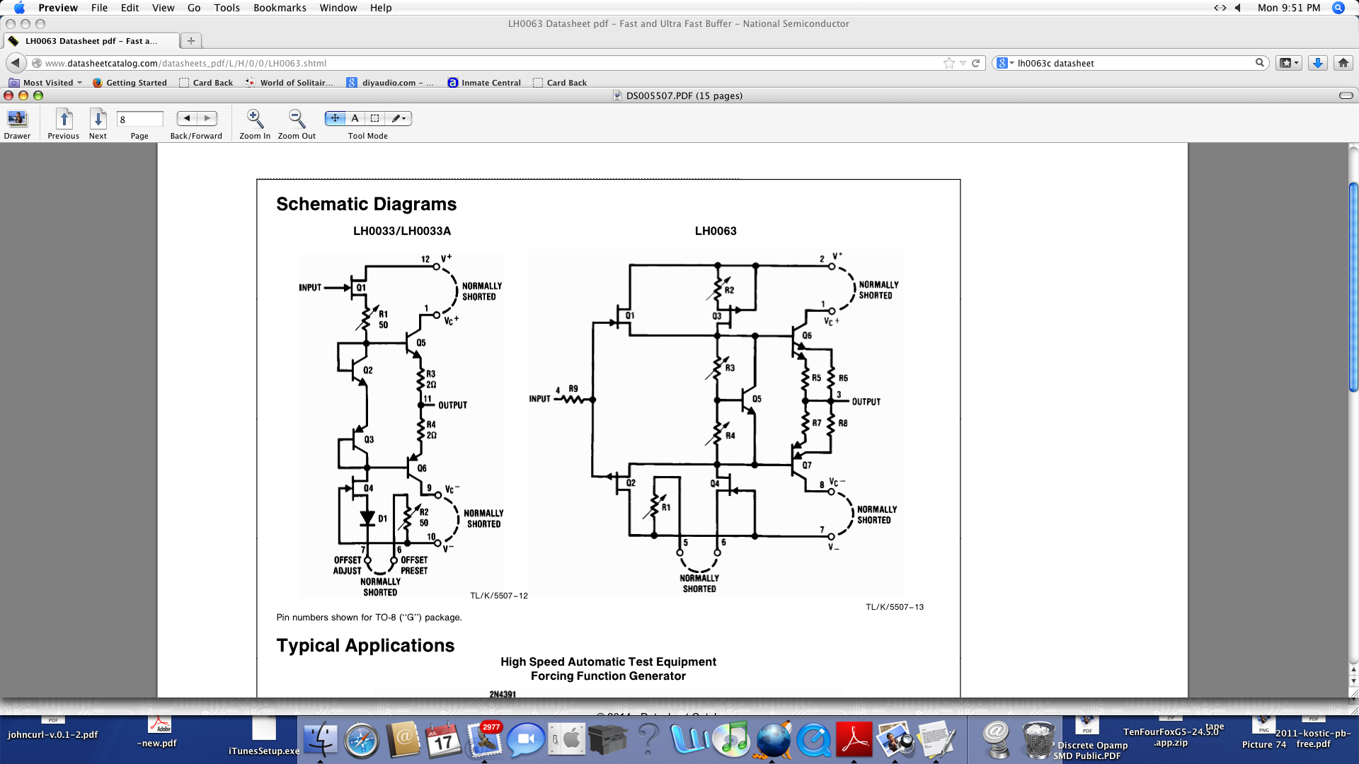

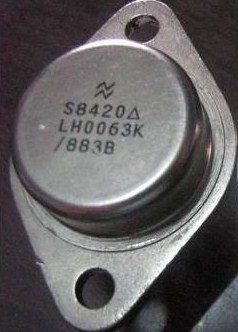

Your buffer is almost ideal, Esperado. It comes from a hybrid device that National Semi offered in the 1960's called the LH0002, that was in a TO-5 IC package.
Nice thing about that chip is that it was fast enough that you could insert it after an op amp and take the feedback from its output. I built a few preamps out of it and they worked very well indeed. It was also available in DIP- I think I still have half a dozen of those in my junk box.
Except that, as drawn, the output pair works in class C . Output voltage is DC zero, opamp output is DC zero, hence assuming Vbe identical for npn and pnp devices, the current through the 15 ohm resistors is exactly zero. In practice, it may be slightly larger, since the driver devices are biased, and hence may have Vbe larger than the output devices. Anyway, far from any optimum bias.
In ICs is a different story, emitter areas ratio may take care of the output pair bias.

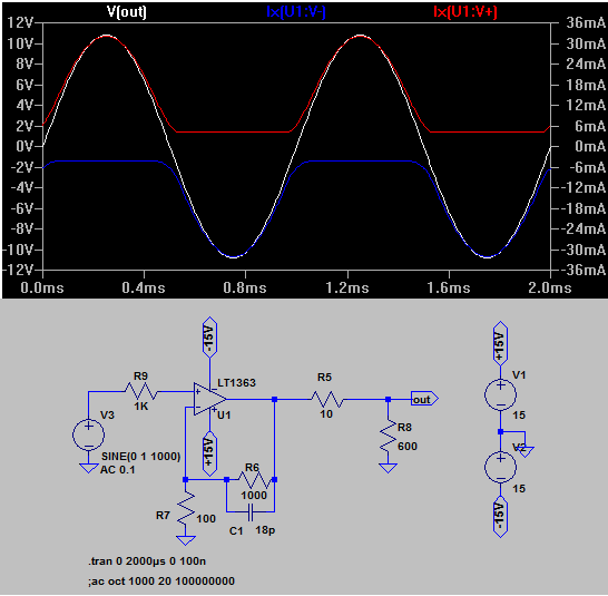

Sorry, but you can do it with the same performance quite without discrete output stage (working in class B with about 1,5mA quiescent current, relying on NFB from LT1363), it is useless. LT1363 is all you need. It is unity gain stable, able to work in 600ohm load with full swing (output current +-25mA), stable in capacitive load...

understand-it, build-it, measure-it
2Esperado
