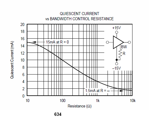

I would still consider a BUF634 set to 30mA quiescent for 12V RMS in 600 ohms class A.
Or an AD815 with 400mA per side Iout, at 15mA quiescent per side.

Look guys, what is important is that you run as high quiescent current as practical.
I think that 1.5ma, although most likely an improvement over what TYPICAL IC's have, is on the low side. 15ma is better. However, when I design a headphone amp, I use 100ma Iq.
My colleague Ron Quan just presented a paper (AES 9197) that denotes the crossover distortion in many popular IC op amps. This is because most the IC's are virtually starved in the output stage, in order to keep within the current spec. demanded by 'management', sales pressure, etc. This is the main source of any higher order distortions, AND even a serious contributor to PIM.
