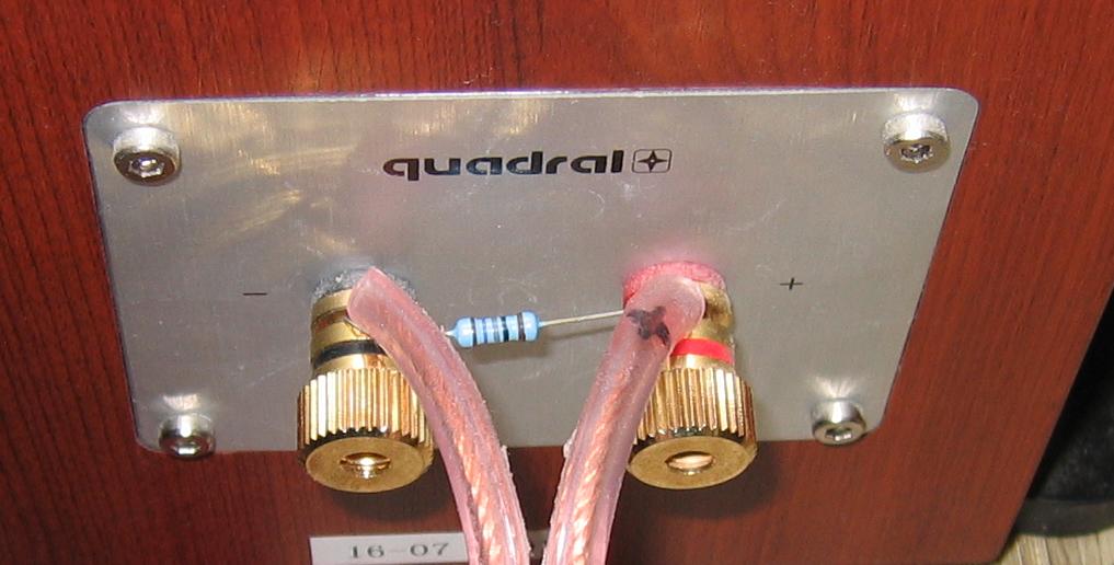

A common practice, at least to some of us.
aha...a resistive zobel;)
jn
That's it. And it works. Resistance is close to cable HF wave impedance.
I can, pavel I hope you don't mind..
When the load "unloads", or goes above the cable's characteristic impedance, the cable will look like a capacitor to the amp. This resistor guarantees that no matter what the load does, the termination at that end will never be above the cable's impedance, so the amp will always see either inductance, or resistance.
For rf, it guarantees that there will not be cable resonances as a consequence of reflections.
The caveat is, if the cable is a low z type, that resistor would be too low a value, and it would consume power. When the cable is very low z, you'll have to put a cap in there as well to protect the resistor against lf power.
jn
How to calculate the cap value?
About the resistor value 100-300 ohms don't change if the loudspeaker have 4 ohms?
TIA & sorry in advance for these newbie wuestions.
