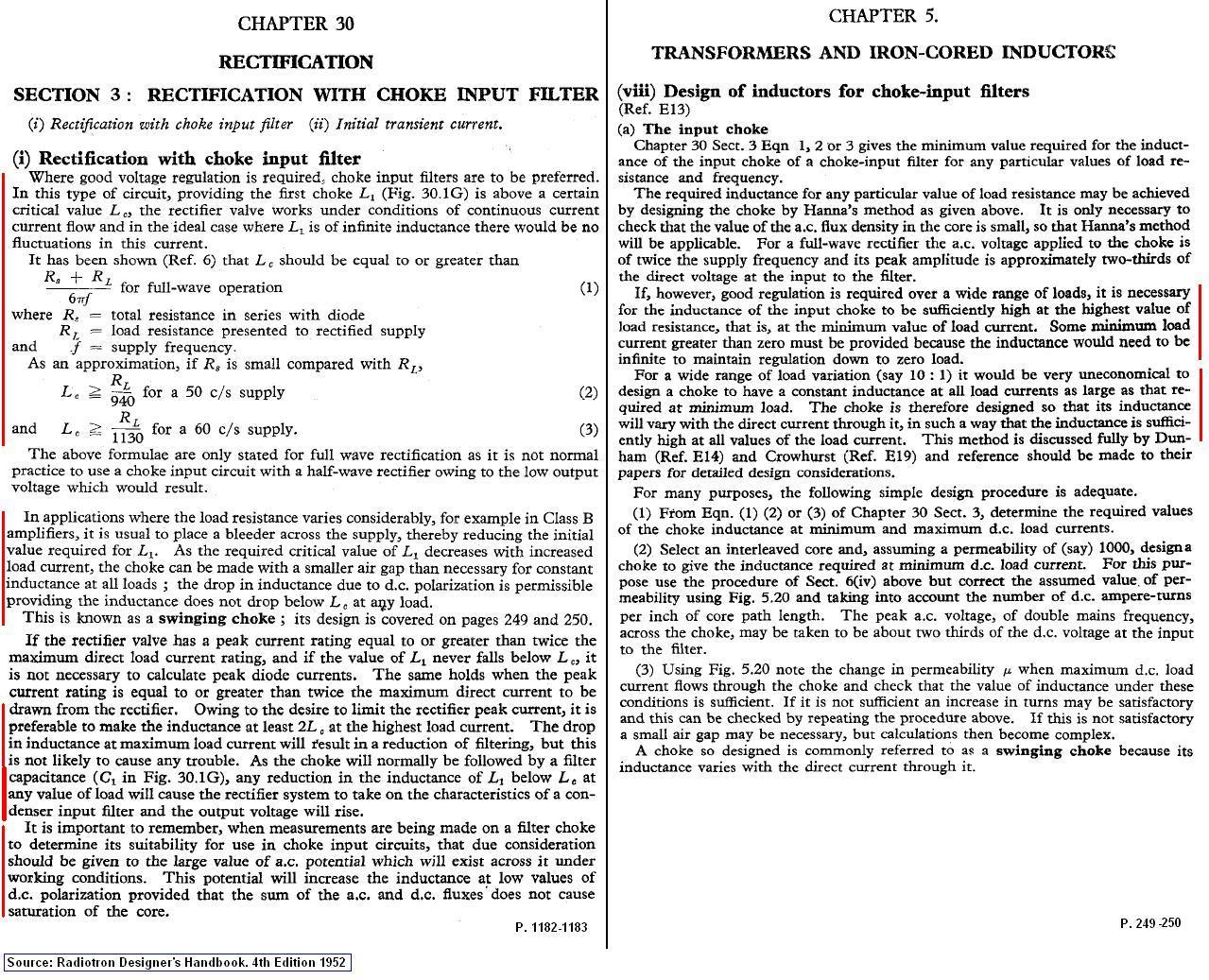

Isn't there something about "Choke based PSU's" that they don't
work with class b (ab) ......
something like sustaining current ?
Yes, works best with some class-a bias , how heavy a bias? Those above floor level will have to chime in .. :)

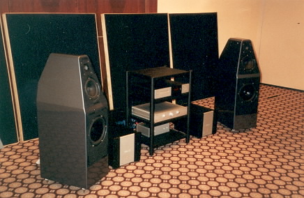

Amps of this kind are often used for very loud sound reproduction. I know at what sound level we listen when we organize a listening session of 10 - 20 high end fans in a larger listening room. Incredible! ;)
I agree with you, a.wayne. The amp should not shut down itself.

http://www.tubebooks.org/Books/RDH4.pdf
>Edit: Sorry Jan.I deleted the post and re-posted it due to some highlight I missed at the attached pic :)
George
Yes, that qoute ticked me off - I just got the manuscript to that Vol 8 article and I saw the same reference.
Author is Rudolf Moers who wrote that 10 pound book on tube amplifier design ;)
