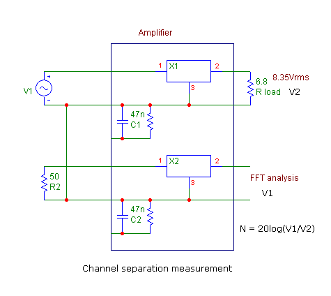

Why not? You only must not send any crosstalk (from preamp or soundcard) to the measured channel. I measure with left and right ground connected together, one channel is driven from generator and loaded by whatever load (does not make much difference), second channel provided with cable and cable input shorted with resistor equal to preamp output impedance.
Everything depends on how your amplifier is wired in the box and if you have completely separated power supplies or not. Power supply (transformer) is the coupling point.

The star ground can be a coupling point. Or, more precisely, the wiring to that star ground.
To accurately measure crosstalk, it is important to exercise the entire system the amplifier is within. This does include the source connections.
For unbalanced inputs, remember that at low frequency both input cables share a common signal return path, and it is not the input cable shields, it is the power cordage ground. At higher audio frequencies, the input cables share return path 50/50. At very high frequencies, each input cable gets it's own return path, it's shield.
Internally, the supply rails to the output stages need the return current co-mingling to reduce internal couplings. How many designers twist the output wires such that the output ground wire goes back to the pass devices, and then twists around both supply rails back to the supply caps?
jn
I have nothing like that. I have two completely independent amplifiers in one case. To me, star ground is a wrong solution.
How do you couple rail to output return currents to prevent solenoidal fields?
Are you using balanced inputs? edit: I see you are, but individually shield each wire..you've a loop at the inputs.
I agree with you that star grounds are incorrect for low impedance circuits.

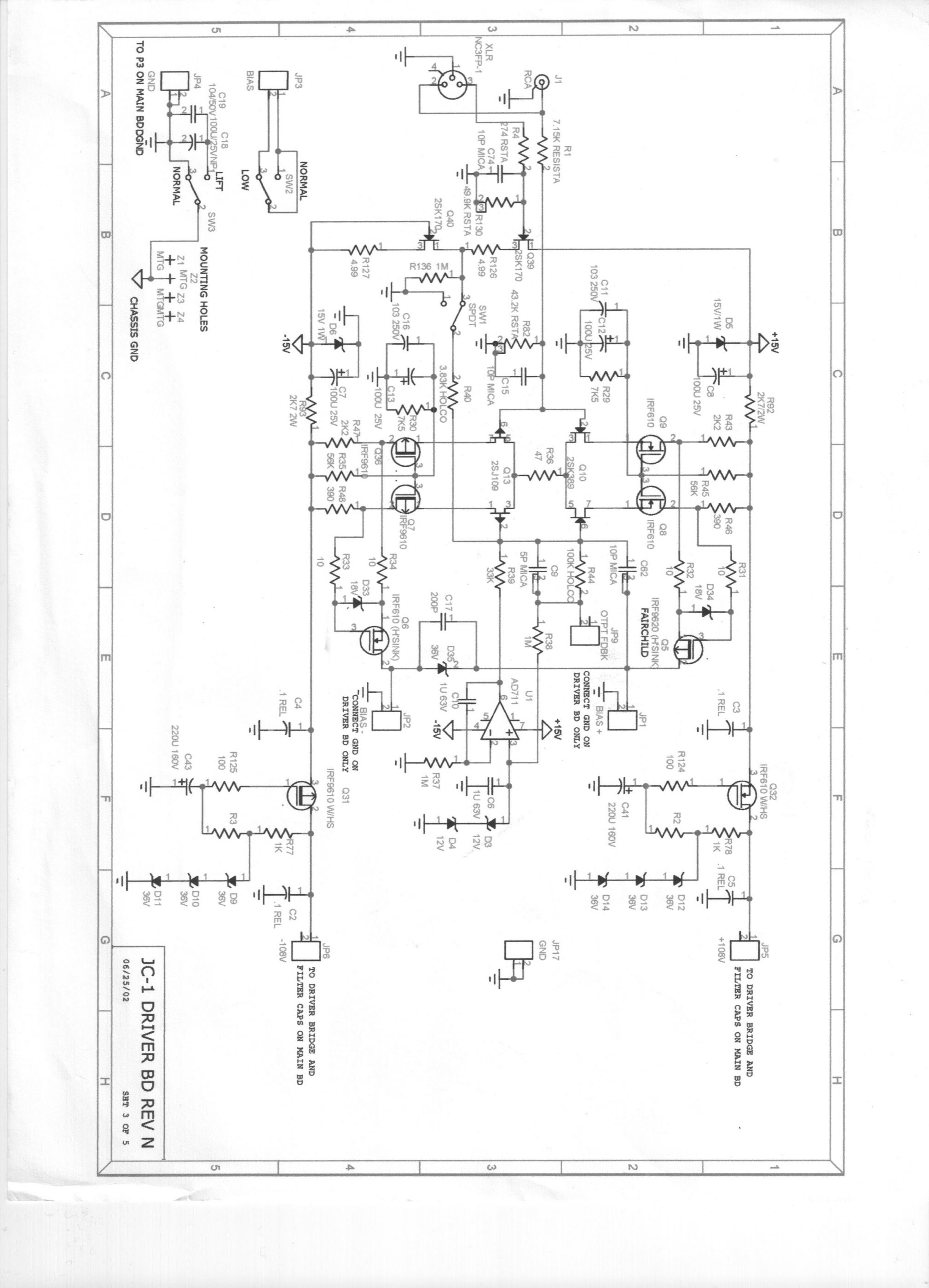

Some of you might ask: Why a 'B' rating, why not an 'A' rating? This comes down to the issues mentioned by PMA, i.e. Layout, heatsink area, and parts quality.
An up-to-date topology such as used by Parasound is only part of the equation. Done without significant mistakes, it can achieve a 'subjective' 'B' rating, but rarely an 'A' rating.
The next most important factor is LAYOUT. I have always had trouble with Parasound over this, until we launched the JC series. It was just outside of my control for about 10 years. As shown in the crosstalk specs, the problem can be measured. Other problems may be more subtle, YET just as 'subjectively' problematic, and without measured PROOF, it is hard to convince someone in Taiwan whom I have never met, thousands of miles away, that these problems are equally important, without measurements showing it.
Things came to a 'boiling point' with Parasound and me about 15 years ago, when Bob Crump, Carl Thompsen, and I were designing the CTC Blowtorch preamp in the USA, and Taiwan was even ignoring some of my original design advice, and our product ratings dropped off the chart.
At this time, my associate Bob Crump and I decided to tackle the Parasound problems ourselves, for our own use. It was relatively easy for me to acquire Parasound amps, but they were then insufficient to be used effectively with the CTC Blowtorch preamp.
Bob, at the time, used a very expensive discrete amp made by 'Bear' who contributes to this website. So when we went to CES, we brought 'Bear's' amp to show off the CTC Blowtorch, rather than Parasound. In fact, nobody of my professional acquaintance would use the Parasound amps at that time. I measured and measured, but I found little out of line.
I donated an HCA3500 power amp that had failed with Brian Cheney (he would not even take it to CES as a back-up amp) to see what we could do with it. Bob REMOVED dozens of parts, phased the transformers properly, exchanged diodes for hi speed ones, replaced bypass caps, and feedback resistors, etc. etc. THEN we had a good listening product, and the next year we took it to the CES to play with the CTC Blowtorch. It was a success, so much so, that we decided to buy Parasound amps at cost and modify them, ourselves, for sale at a modest profit. We did this for a couple of years, but it just was too much work, so we considered stopping. Then Parasound came to realize that maybe our upgrades, and even more (like better layout) would make some Parasound amps venture into 'A' territory, and the JC-1 was designed and built, then the JC-2, 3, following our mods that we knew worked, yet we could not easily measure the differences. And that is where we are today.
Interestingly, we did NOT change the basic schematic much, just attention to details. (JC-1 example to compare to earlier designs)

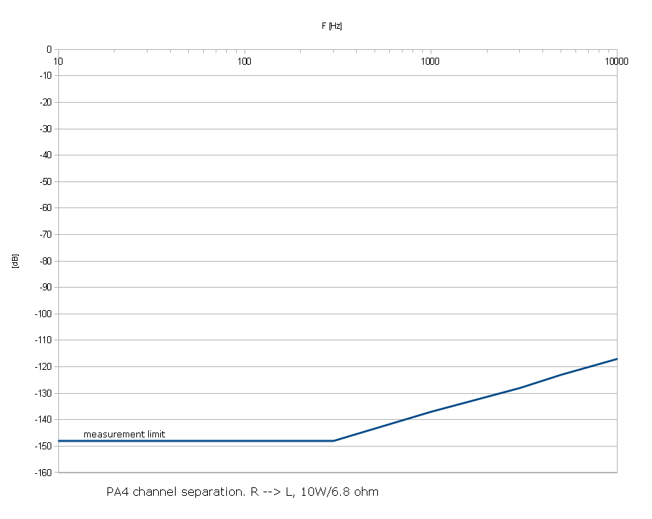

JN, you are quite curious ;)
The prototype measured has only unbalanced inputs. It was measured the same way as when it is used for playback, pls see attached image. Regarding internal wiring - that's something I do not want to speak about in detail.
