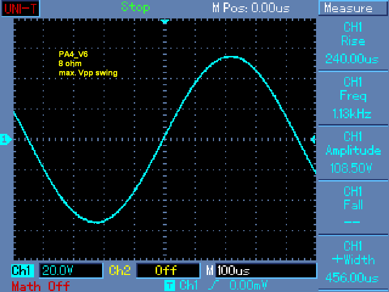

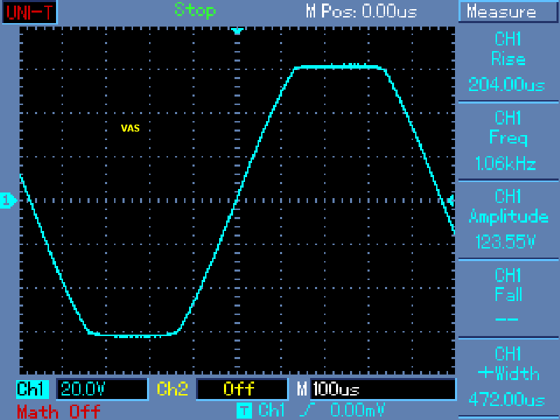

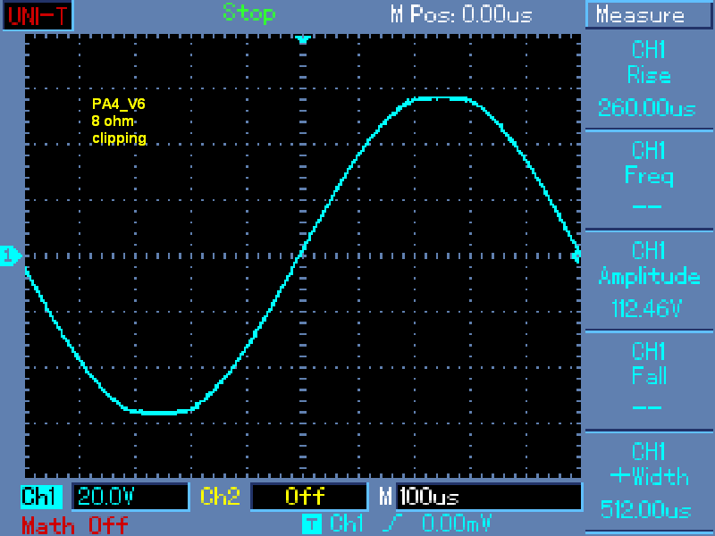

Might be interesting, at the moment, to show VAS maximum voltage swing and maximum output voltage swing of the power amplifier loaded by 8 ohm. Both as clipping. And maximum swing for undistorted output (180W/8 ohm approx.).

It was output clipping without any doubts.
That part was clear. The question is what happens immediately after? The clipped waveforms into resistive loads look clean, no indication of squegging or sticking, but tonebursts into reactive loads tell the tale. That's one reason that PowerCube (or similar) measurements are very useful for judging commercial amps and diy amps meant for a wide range of speaker types.
