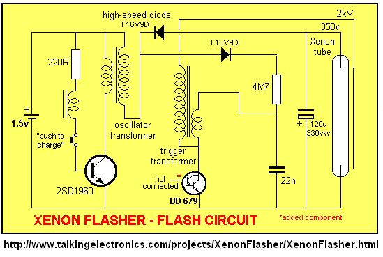

I've seen this several times in print, a capacitor suspended on long leads over a driver running high SPL. I never tried the spark test, it does nicely separate the electrical from acoustic stimulus and the peak SPL is pretty high. In fact the results can be unambiguous with time windowing, I think I'll put it on the to do list.
What is the spark test?
Is it a capacitor // to an air gap fed with a high voltage up to the gap’s breakdown voltage (test the cap during the discharge)?

Exactly, the method is to build up a charge on a low inductance capacitor and to dump it all at once into a spark gap. The trick is how to trigger the gap. The easy method is with a small flash transformer spark to one of the electrodes. Very 1930's.
The EMI travels faster than the shock wave so you might be able to tell them apart.

Here you are and it does a repetitive trigering.
Two capacitors for you for this ambitious testing (plus a resistor and why not a transistor too).
Shielding from the transformer fields will be required.
Xenon Flasher

"This project generates 350V DC and stores the voltage in a large electrolytic. This voltage will not kill you, but will deliver a nasty SHOCK! For this reason, the project has a great benefit. It will teach you to work very carefully on equipment with high voltages and if you do get a shock, you will appreciate electricity EVEN MORE!"
By George you've got it. At 30 cm you have almost a millisecond difference between EMI and pressure wave.
In Latin it is improper to end a sentence with a preposition. For some arcane reason this rule carried over to English. So when someone corrects you for ending a sentence with a preposition such as "with" just add at the end mother F'r. (Old bad joke )
Brad that circuit shown is much better then the Popular Electronics version that used a direct AC line powered voltage doubler to the power supply capacitor. The circuit shown requires a transformer that would be difficult to get until you realize the complete circuit is available in any disposable camera. (If you can still find one.)
