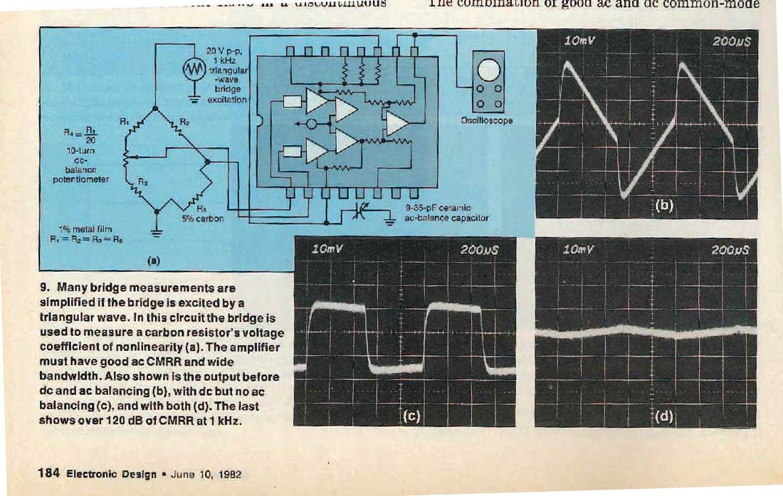

ED, I can finally say like JC I did that 30 years ago. This carbon comp resistor was really bad, excess noise up the wazoo, but distortion did not even register, go figure.
Well let us see, Wheatstone did not invent the bridge circuit that bears his name. The circuit you showed looks like it has a typo inside the IC package.
Sam Groner would chide you for the lack of CMMR.
But as close as that circuit gets, there is a difference between the goals in it and what mine were. You used three 1% metal film resistors as the reference. In mine there are 10 "Identical" or at least similar resistors. By using reciprocity and a large sample of resistors it becomes self improving. That is a point so many miss.
Now the triangle wave was popular when used with an oscilloscope before FFT analysis became so easy. But I think we went over how easy it is to get a good clean sine wave orders of magnitude better than what you can do with a triangle wave generator.
So yes you were 29 years ahead of the issue, I just can't give you all of it!

AD624 Alternatives...
The AD624 in its version/performance variants is getting to be very old, and seriously expensive.
Is there a modern replacement with performance good enough/better than the AD624 to perform the bridge mode component testing as described in the 'Electronic Design' article posted above, or is the AD624 still top dog ?.
Dan.
