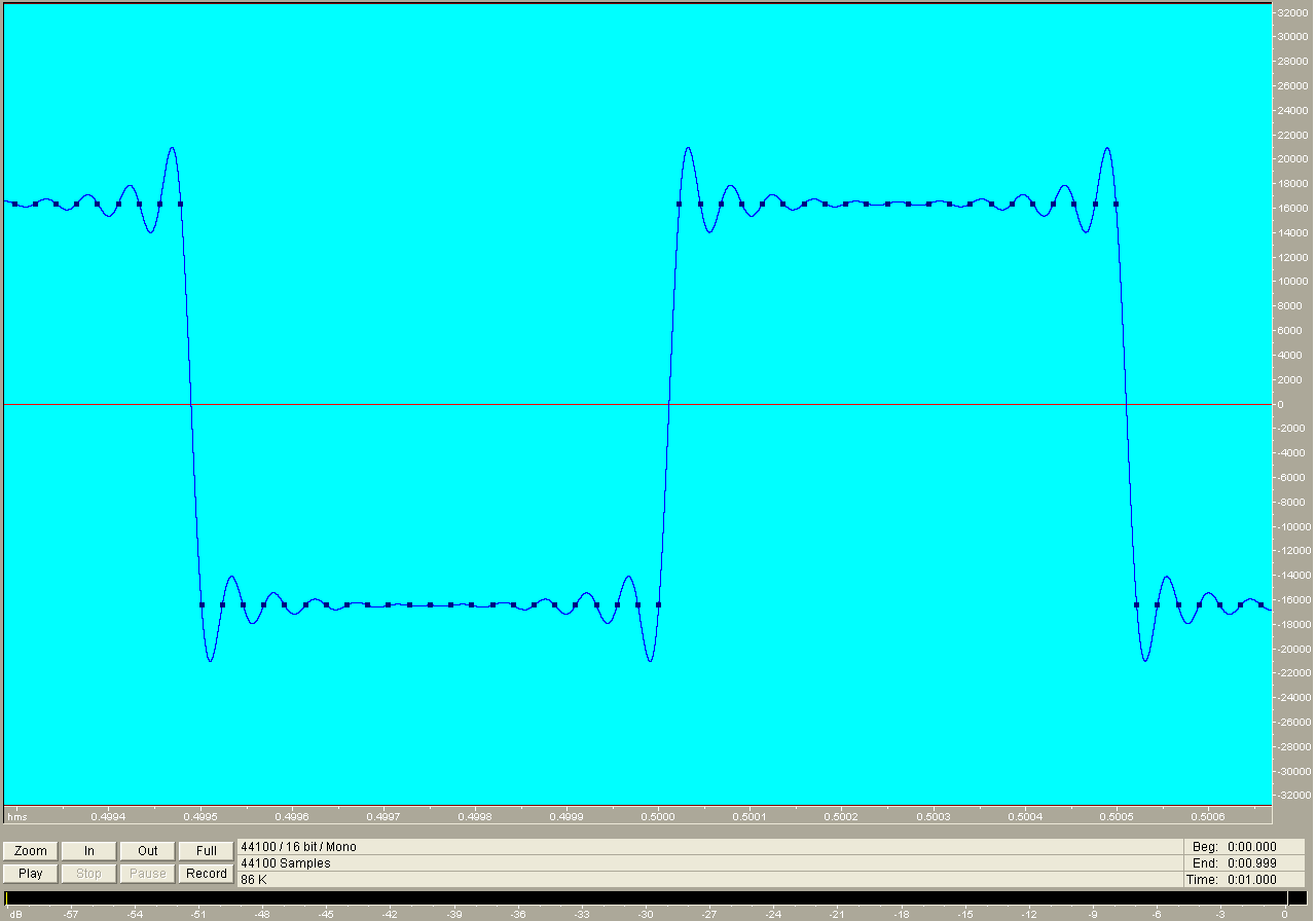

For Frank, 1 kHz square with 44.1kHz sampling. Only 2 "digital values" are present. Not sure it these explanations would make any sense in this particular case.

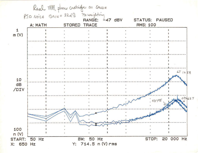

More office cleaning, here is a noise plot I did years ago using a Shure style MM cart with the stylus removed as a source impedance.
So the cursor at 714.5nV is referred to the input, divided by the gain of times 40, as about 18nV/sq rt Hz? Or, wait, I see that the BW is 50Hz, so I guess we account for 7.07 sq rt Hz?
This in any case certainly underscores the importance of low parallel noise, as the LT part does rather badly at high frequencies. Do you recall what the actual cartridge model was?

I think I still have it in a junk bin at home, IIRC it was not a Shure but was very close to a V15 in inductance and recommended cap load. Thes e were just for a relative comparison, I guess there is enough info to get the actual numbers. Good old HP pen plotter, the only output device available.

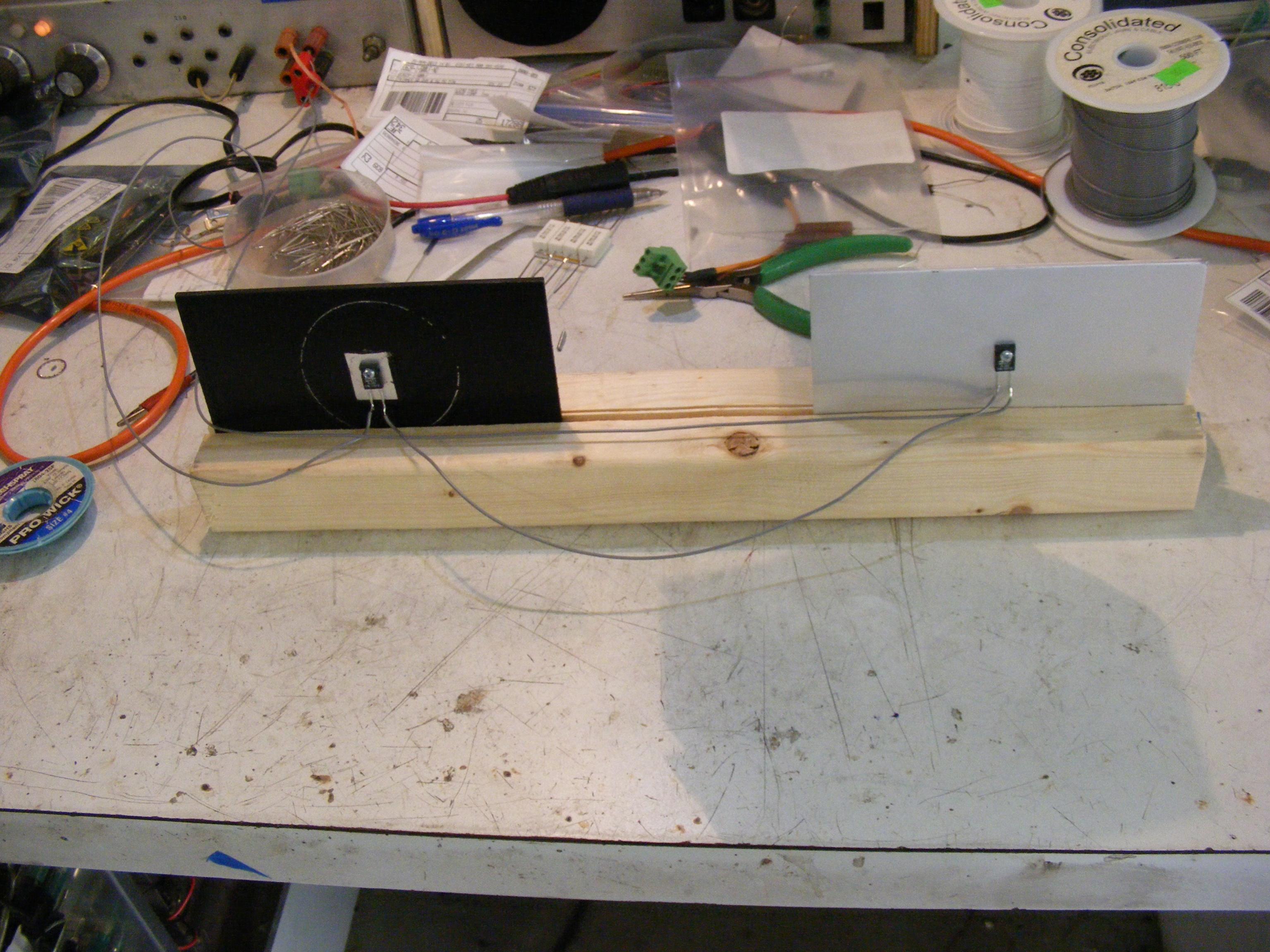

Scott,
In looking back on this thread there was an issue that we didn't quite settle on.
Attached is the picture of the setup. A current source of 1 amp was used and the voltage across the resistors was 7.32 and 7.31 volts. Both pieces are .125" 5052 aluminum 3' x 6" with the hole .125" centered. The finish was mill finish cleaned with a lye bath. Paint is Rustoleum Flat Black spray paint both sides. Temperatures measured using a bead thermistor in direct contact at the heatsink back just under the mounting bolt were 39 & 42 C.

Yes, that's fine. In the digital world everything behaves as it's meant to, providing no-one has made a really silly mistake - or is attempting to do strange filtering, to pre-process the waveform before it hits the DAC, in order to compensate for the latter's 'inadequacies'.
I've gone through the exercise of creating a perfect digital square wave, just 2 values as you say, and then passing that through digital equalisation, with as close to perfect pass band as can be specified. And, out pops a digital waveform that looks exactly as you have shown - the application of the filter has demonstrated the ringing, or "rounding of the corners" necessary so that frequencies beyond the Nyquist limit don't intrude. All in the digital domain ...
However, this only tells us what then theoretically happens in the analogue reconstruction arena, - what does happen, especially with "from hell" waveforms, is a function of the designer's mindset, and the competence of the implementation ...
