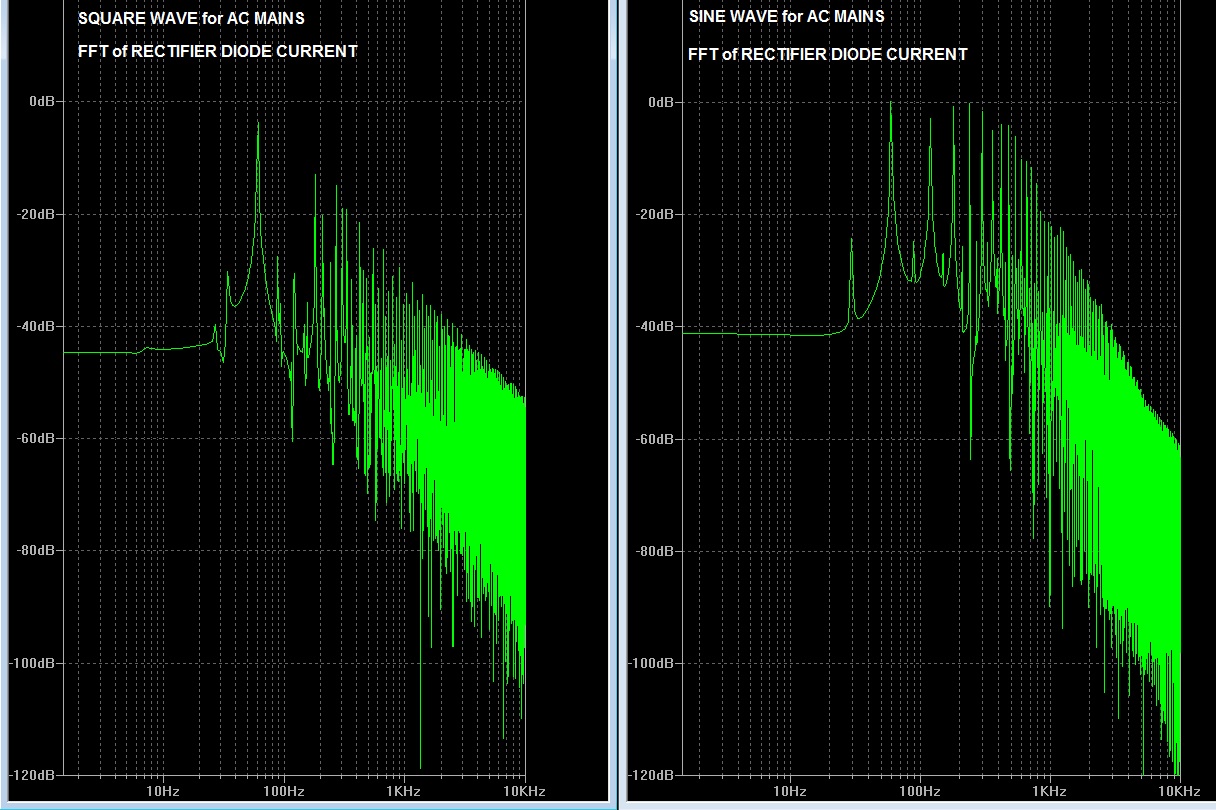

Talking about varying the mains frequency made someone ask me about using differently SHAPED mains waveforms, instead. Has anyone here thought about or tried that?
It might sound crazy at first, but a square wave could work very well. It certainly makes efficient use of the time available in each cycle. And it doesn't have those pesky peaks.
Of course converting to square first would lose at least 30% of the amplitude. But this is probably just an academic exercise, anyway.

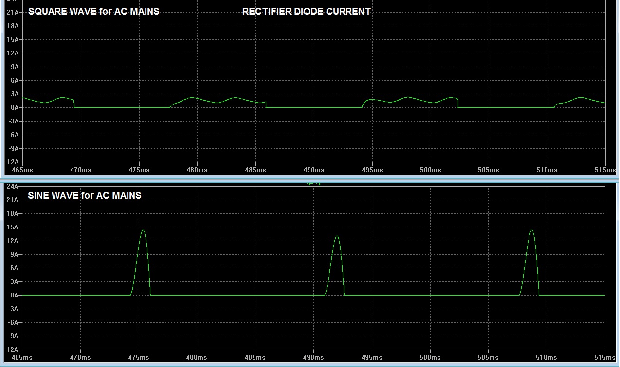

Since it was so easy to do, I tried using a square wave for the AC mains, with my existing lt-spice sim of an unregulated linear supply and power amp pushing a sine signal into a resistive load. I think it was set up for a 270 Hz sine and 100 watts into 8 Ohms. I just used a square wave of the same peak amplitude as the sine I had been using, for the mains, which was about 116 x 1.414.
As you might imagine, rectification of square waves is much more beautiful than with sines. I only did a few quick checks but found that the diode current peaks were about 20% as large and the ripple voltage was about one third the amplitude, and better-behaved than with the sinusoidal mains.
I just thought it was an interesting concept. It's probably not too practical, since it would require an extra stage to convert to square waves.

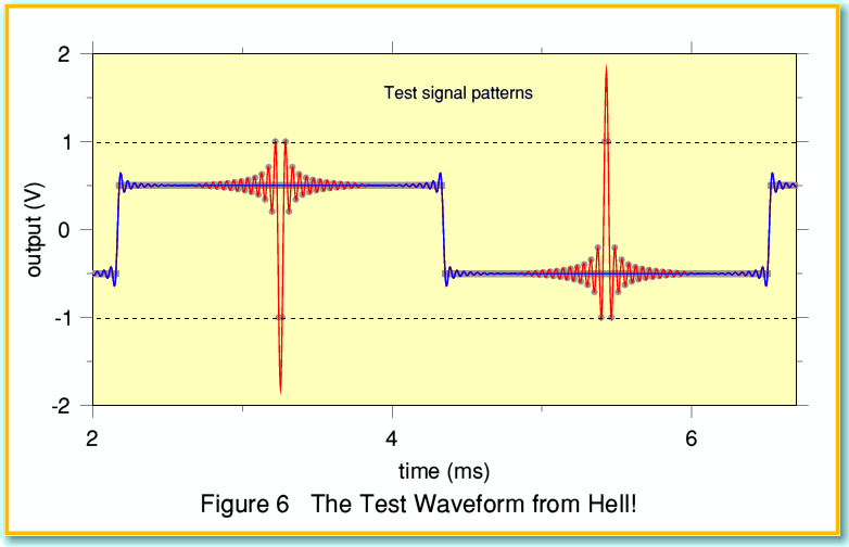

Not "amusical," but "non-physical." Do you understand what "anti-aliasing" and "reconstruction" are? Even if the basics of sampling theory elude you, it's not that hard to do a couple of actual experiments to see why your example is not possible.
Perhaps his example isn't possible but the issue of overloading a DAC is very possible with a 0dBFS signal. Most likely with an oversampling DAC that has a digital filter. Early examples did not account for the peaking that comes from the sharp cutoff filter on transients. Philips had a real problem with this that Keith Johnson pointed out to me. Current practice is to manage the internal gain to prevent the issue.
Square waves, real or synthetic, will have ringing to some extent in DAC's: Gibbs phenomenon - Wikipedia, the free encyclopedia not a nice rounded leading and falling edge.

Nyquist made the call long ago - any analog input signal that fits the sampling theory's amplitude, frequency limits can be exactly digitally encoded and properly decoded
there is a converse "problem" - not all bit patterns that fit the digital format's amplitude, frequency limits can be fit to analog waveforms with the same amplitude limits
an example is a digital fs square wave - Gibbs phenomena will give ~ 2dB overshoot in the reproduced analog output if the DAC doesn't saturate
so some digital mode edits can create signals that cause "overs" of the analog (or interpolated) output
of course you can intentionally do even worse...

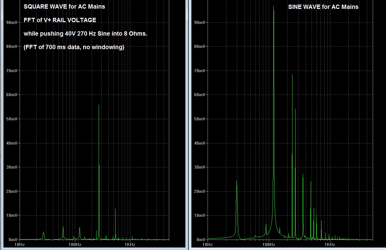

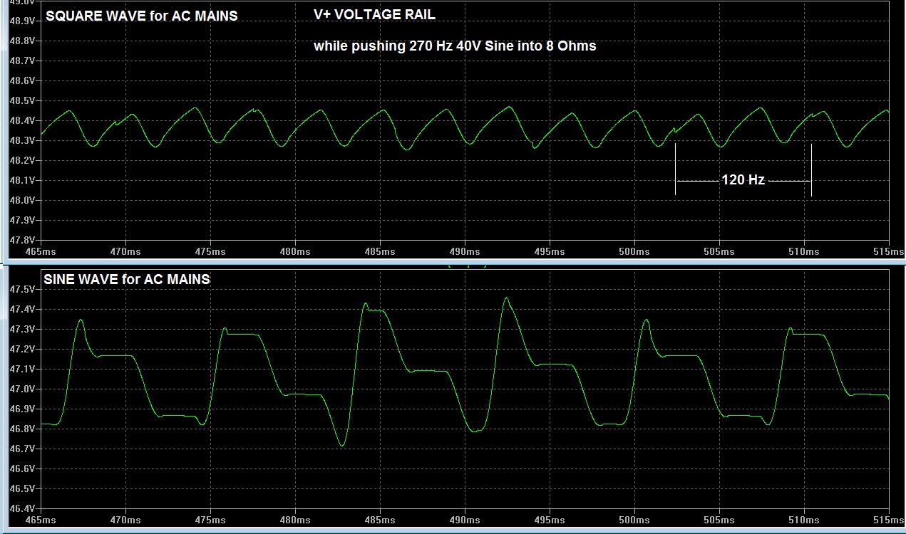

I ran the LT-Spice simulation again, with Square and Sine for 60 Hz AC Mains, and took some recordings of the rail voltage and its FFT, and a rectifier diode's current and its FFT.
This was with a linear PSU with a transformer with 35 VAC RMS output secondaries, wired with no center tap and two rectifier bridges (modeled with 4 MBR20100CT Schottkys each), a 20000 uF 100V cap per rail (each with 0.01 Ohm ESR), and an 8 Ohm resistor load, with a BJT Class AB power amp using one each MJL21193 and MJL21194 with 0.22 Ohms Re, for the outputs. The peak voltage for both the sine and the square "AC Mains" input was 163.91 Volts.
Images are attached. There are significant differences. But I don't think it made any difference in the output FFTs.
Edit: Can't remember if cap was 10000uF or 20000uF when diode current FFT was taken.
