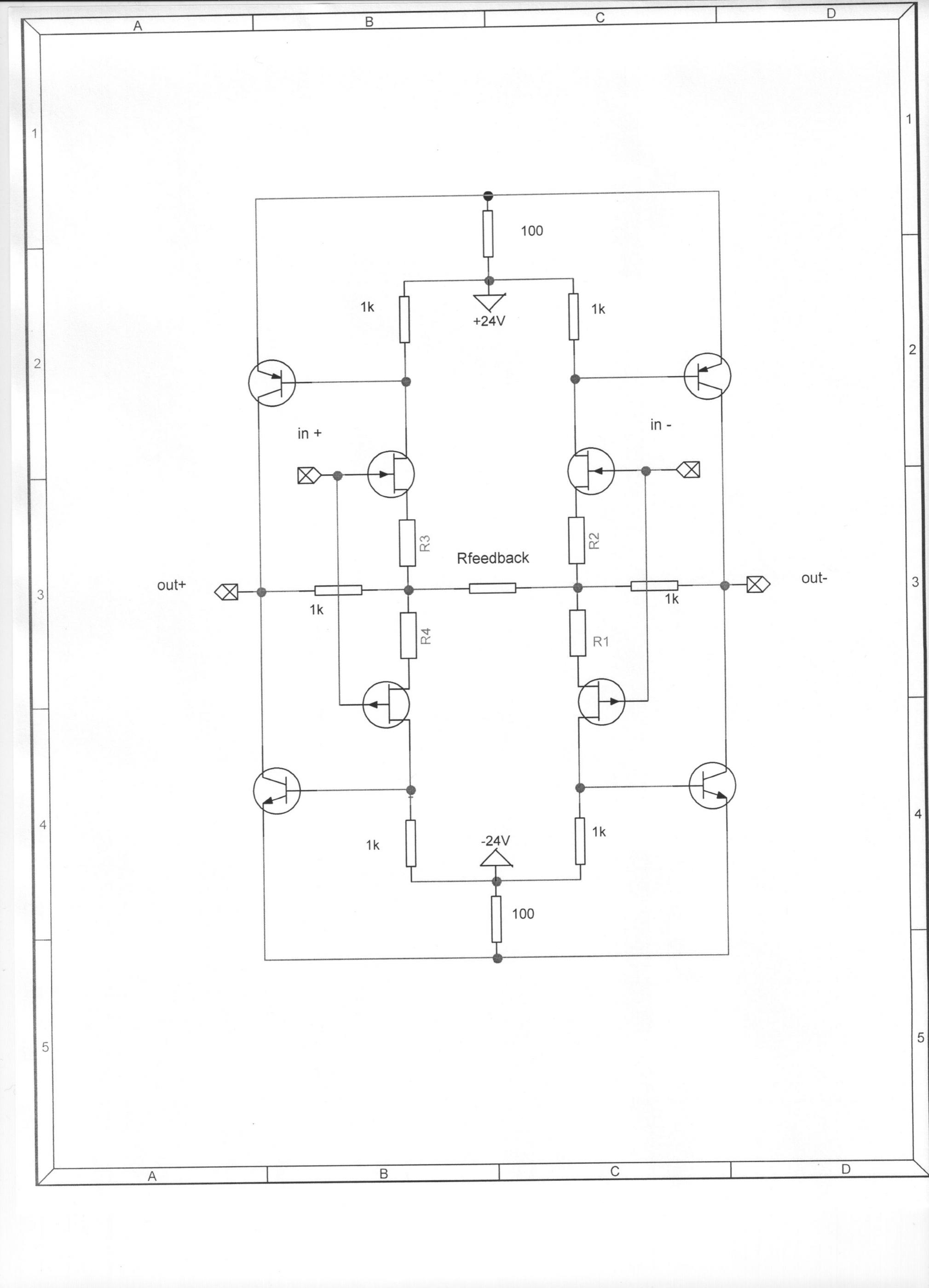

You mean on the input JFETs, something like this?
I'd expect lower input capacitance, but possible stability problems. Haven't a clue about the effects on open loop gain and linearity. Anybody else can shed some light?

One detail which is rarely discussed if at all: some imagine that the added device causes the drain voltage of the input one to move precisely with the input gate. But this ignores the actual impedance at the added device's source, which is no less than the reciprocal of its own transconductance and that only when the added device's drain is a.c.-grounded. When it moves as it usually does, the input device sees even a higher impedance at its drain and consequently there is less reduction of the input device drain-gate capacitance as well as other usually deleterious effects.
Although I don't like the parasitic body diode in DMOS parts, using one for the added device in the cascode looks to provide better performance than a usual go-to JFET like the 2SK246 (Erno's favorite for N-channel cascoding) or a JFET from the 2N4391 family. The DMOS has to either be a depletion-mode device (unavailable afaik in P-channel versions) or one has to contrive a bias source of several volts, for which photovoltaic optocouplers can work well. And of course there are bipolars, which need as well a little base current.
But these combinations can work well to reduce input capacitances and their voltage dependencies. Of course if your source impedance is low these are generally negligible contributions to distortions.

Here is how we can easily bias a 4Q ckt:
The bias resistor(s) R1,2,3,4 in this example are perhaps best at about 20 ohms. This is done by getting a graph of I output current vs V bias. Note that both the P and the N devices will 'track' pretty closely.

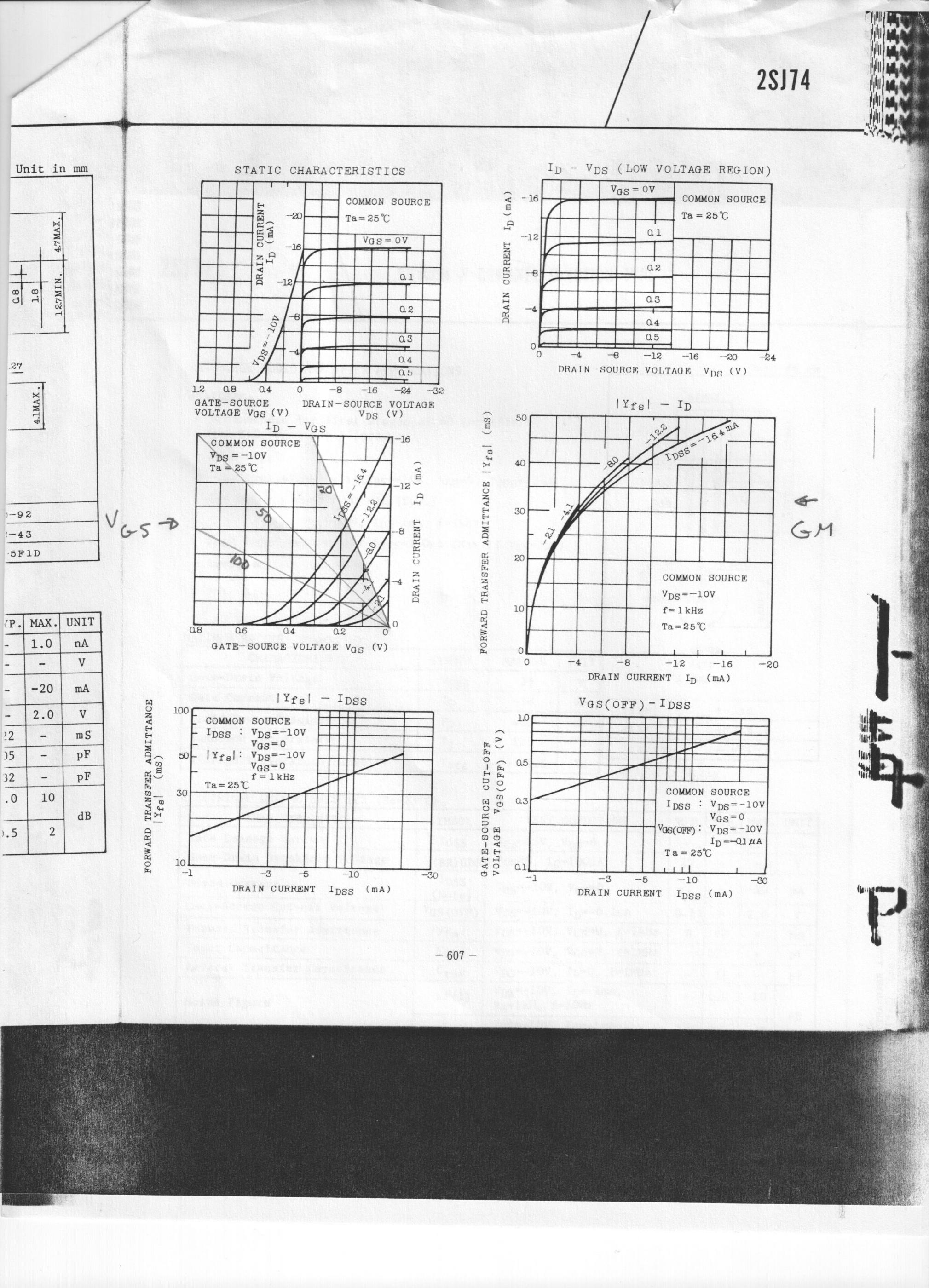

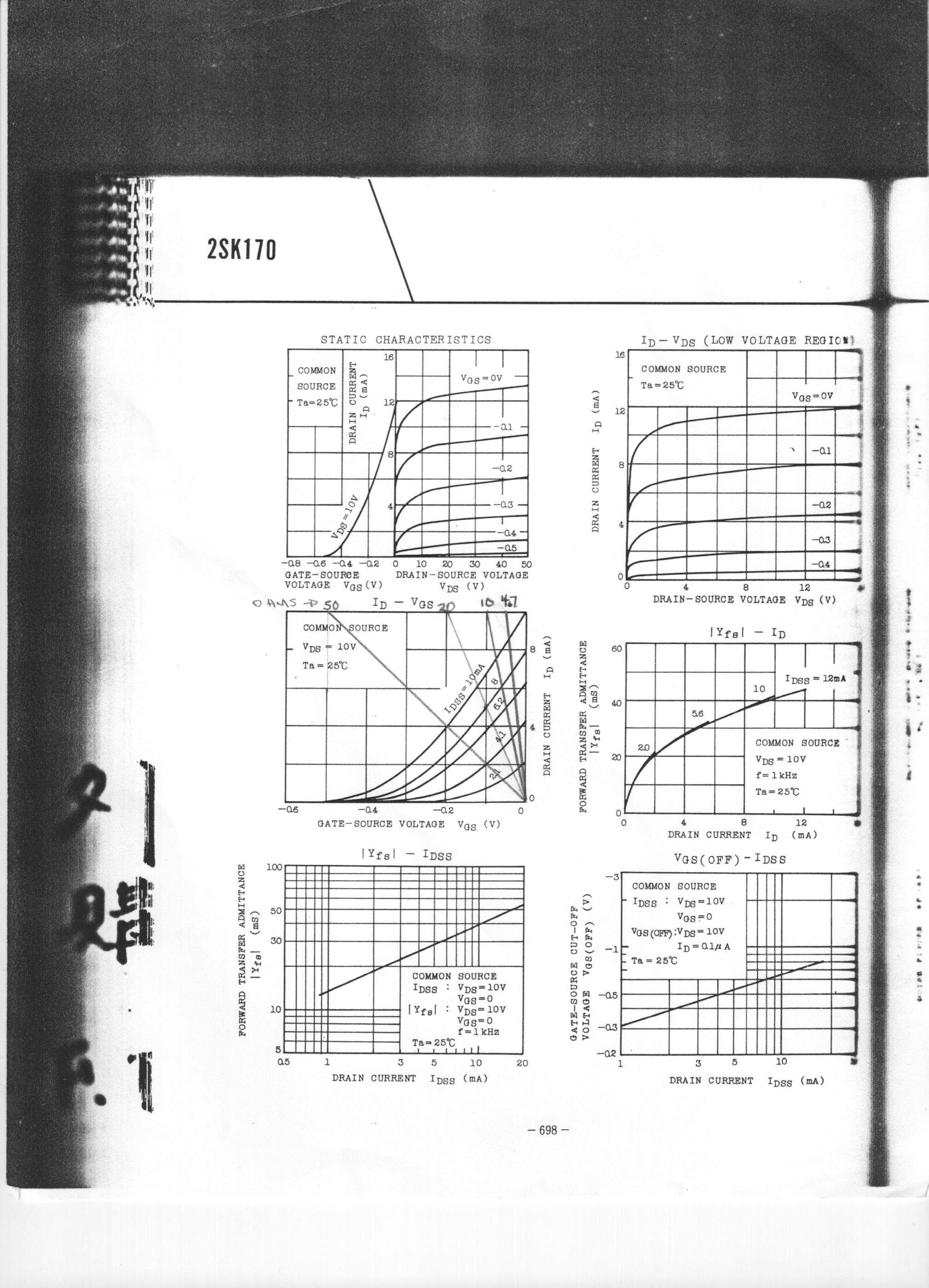

Transconductance of 325mS at 120mA, but far less pretty under 10mA drain current.
Two K170GR in parallel would have an impedance under 25R, with J74 available.
(a relic like me still has a bundle of Grey J72/K147, and diy folks can still opt to locate NOS complementary parts with high gm numbers, as e.g. J104/K364)
Bcarso, while high Gm is not a bad thing, it also tends toward low Vp and this is not so good. That is why, we tend to use very high Idss-medium Gm devices in order to get a greater Vp so that the input device operates more like a real jfet.
