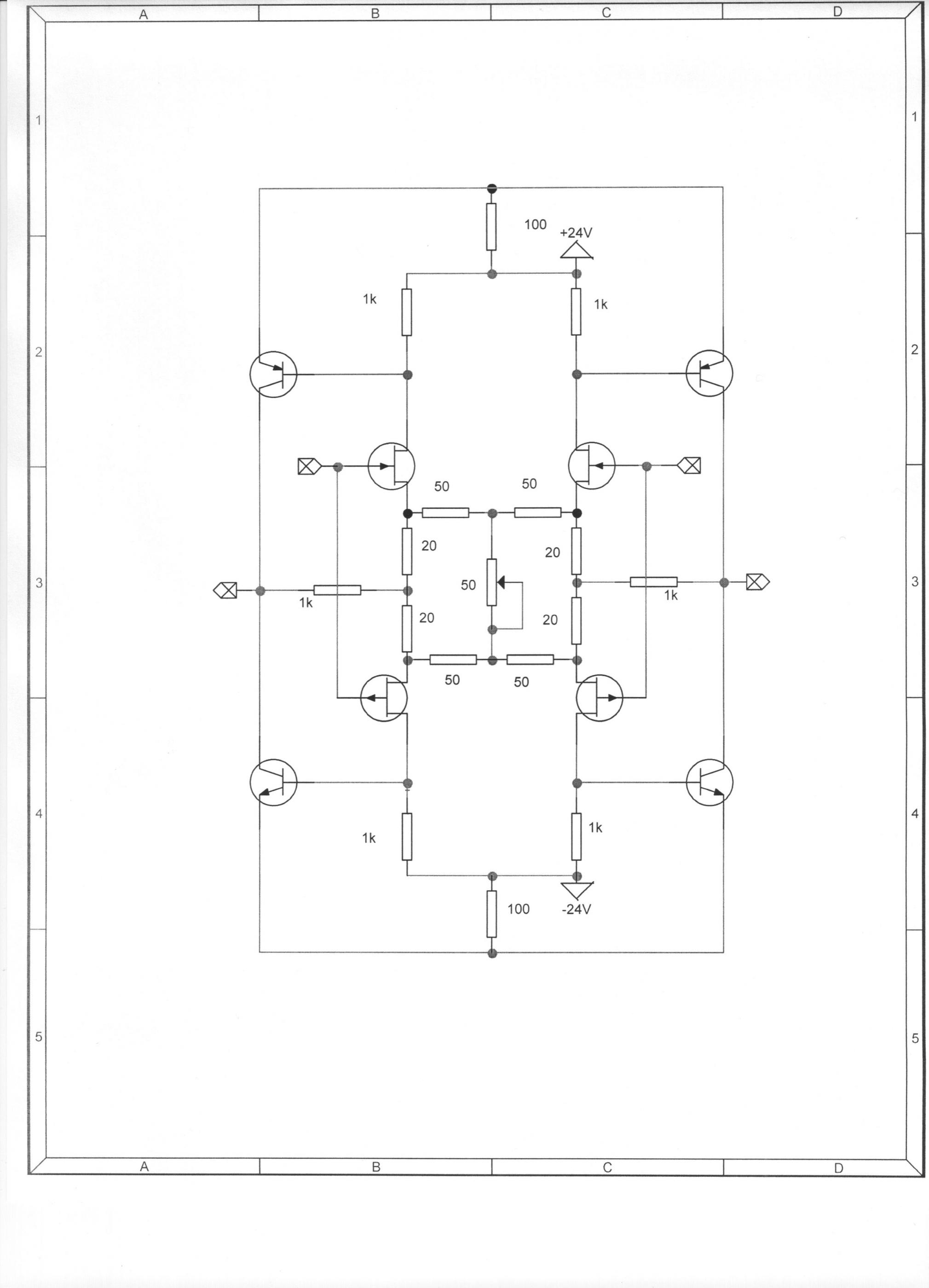

So getting back to the schematic from post 38464: if you just consider an upper or lower half, and suppose for the moment that the active devices are voltage-controlled current sources, the topology is essentially complementary feedback pairs as current feedback amplifiers, connected "back-to-back". The difference in output magnitudes when only one side is driven is easy to see based on the input section side having the traditional resistor ratio + 1 gain, and the other managing just the resistor ratio. If you sense the differential voltage at the outputs you get the same magnitude as when you look at the output of a single side with half of the cross-coupling feedback divider resistance tied to common.
One unusual thing is the treatment of the bipolars (in this embodiment), which have their emitters tied together and the total emitter current supplied by the 100 ohm resistor to a given rail. It's tempting to suppose that the cross-coupling in this fashion is in some way key to the circuit operation, but I think not: it doesn't hurt, but the main advantage is the setting of stable bipolar quiescent currents, compared to the less-certain simple pairing of CFPs. And it allows the input devices to develop a substantial open-loop voltage gain at the bipolar bases, without requiring some constant-voltage device in each emitter. With the arrangement shown each bipolar sees the emitter impedance of the other, which at healthy currents is low. Hence locally the gm of the bipolar is halved, but still plenty high for what the likely currents are.
When we add the complementary half to the other we also take care of supplying current to the JFETs as well as getting the effect of paralleling for lower noise, without requiring additional resistors or current generators.

So getting back to the schematic from post 38464: ..........The difference in output magnitudes when only one side is driven is easy to see based on the input section side having the traditional resistor ratio + 1 gain, and the other managing just the resistor ratio. If you sense the differential voltage at the outputs you get the same magnitude as when you look at the output of a single side with half of the cross-coupling feedback divider resistance tied to common.
this is exactly what I said, but you explained it a bit differently and perhaps more clearly. I was told my explanation was too general and my example using opamps was irrelevant...due to..using evil opamps I guess and my simplified example taken too literally.
Some were unable to recognize it was deliberately simplified and that my resistors R1 and R2 didnt relate directly to part assignments in the schematic. also because I stated that I hadnt yet studied the schematic, rather just stating a more general situation that occurs, this somehow made the supposition irrelevant...
bcarso,
I am dumb. Would you, please, educate me and show me the formula using exact values from the John's schematic how to calculate gain for both sides?
Don't just say it's traditional, easy, this side, that side, other side etc. Show it.
Thank you!
Not so easy, is it?
Not like simple op amp examples. Yet it offers certain advantages such as balanced and unbalanced inputs and outputs, a sort of symmetrical elegance, and pretty low distortion and noise, without too much negative feedback being necessary.

Actually it is, if electoj follows my hint. Symmetry simplifies many problems in physics and electronics.
