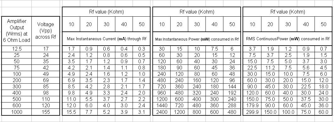

OK guys.
Before I get crazy with the scrutinizing of the feedback resistor (Rf) issue, I tabulated some calculations (attached ).
Plug your tempcos and the like and see what you will get from these.
I hope it helps
George
Looks like ur working on an advertizing campaign for bulk foil resistors
George,
100 W 6 ohms (?) P=E^2/R = Vrms=24.5 Vp-p = 69.29 at 10K =.48W Peak but really .06W. At 8 ohms Vrms=28.28 P=.08W So with a KOA/Speer 1/4W 10K Carbon film resistor I would expect .00052% distortion @100 Hz. from the feedback resistor. The LM4562 lists it's distortion as .0003% so the resistor is not as good as the "Horrible" opamp.
The other minor issue was the paper Dimitri posted was based on the research in the 60's when resistor distortion first really got attention. In those proceedings it was decided to be needed to test each resistor as they were not consistent. My method uses ten of the same and is used to select the manufacturer and type of resistor. They looked at third harmonic as it gave then the information they needed. The rest of the distortion they lumped into "Voltage Coefficient" With the much better gear today we can break out different orders of distortion, drift and increased noise.

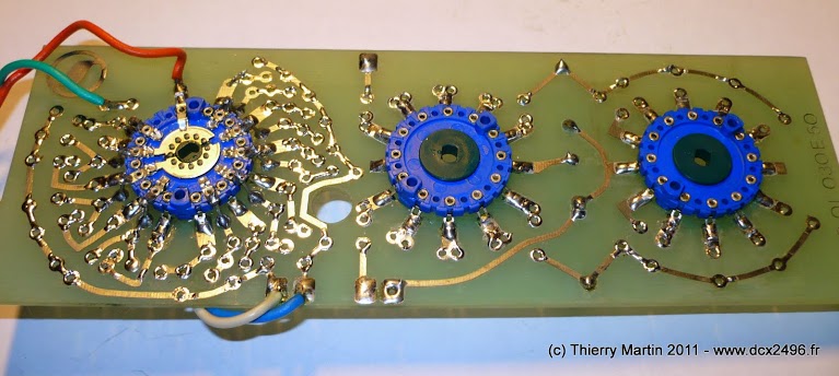

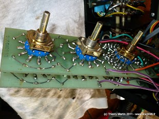

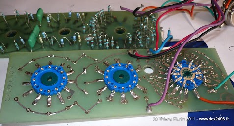

How we addressed this problem in 1970 ?Back in 1974, we found BIG PROBLEMS with first rate potentiometers in regards to HARMONIC AND IM DISTORTION. Some of the most expensive and best known potentiometers suffered from this problem..
A 24 position array of resistances for volume, and 2x12 for Baxandall The resistor bridge was constant impedance source and they were a "physiological" filter following the Fletcher & Mudson curves.

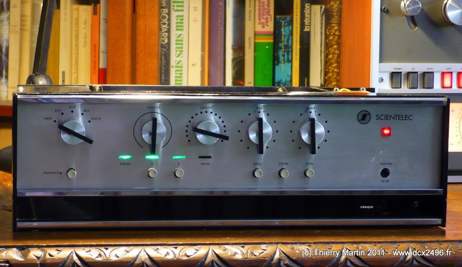

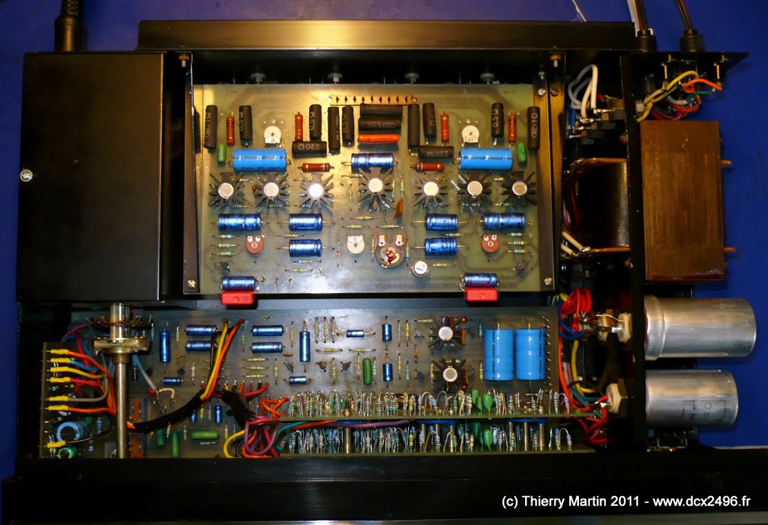

Scientelec Mach 50 was a 2X50 Watts rms combo, witch, more than 40 years later still measure 0.05% of THD @ 50 watts. It was sell 2000 Fr at this time. (2,551.69 today USD)
