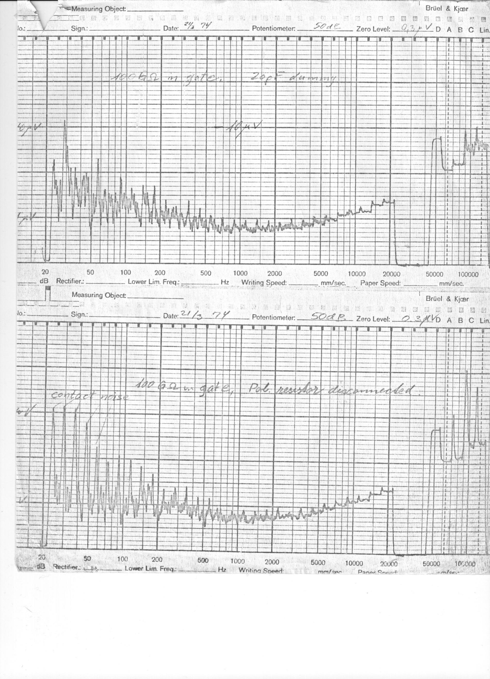

ORIGINAL schematic for the B&K microphone preamp. It had the equivalent of 100 meg input resistance.
R8 and R9 are bootstrapped from the output through R1/R4 divider...
Bootstrapping does nothing for noise. One might ask why 200Meg resistors certainly special order non-standard values. AB only made carbon comp 1/8W up to 56 or 62 Meg in the standard sequence IIRC (try and find them now). Four of these in series would work fine. Before you say it, no DC current no excess noise, just plain physics please.

Well everyone, I hope I have given you enough to make my point. However, I am still missing (they are here somewhere) a complete set of noise measurements taken by B&K where they changed the microphone's R's to higher and higher values. It will come around sooner or later. I'll give you a sample, with 100G resistors.

What does the bottom plot on that page say, John? I can't make it out.I'll give you a sample, with 100G resistors.

Dimitri and Scott, why do you think they bootstrapped the input resistors? Answer shortly.
Because they probably learned physics in school, so loaded capacitive capsules on higher dynamic resistance than they could get statically using available resistors, to get better frequency response on low end.
Actually, it was a routine even before that, because tubes had significant grid currents that limited values of resistors that won't allow to use bigger values of resistors.
