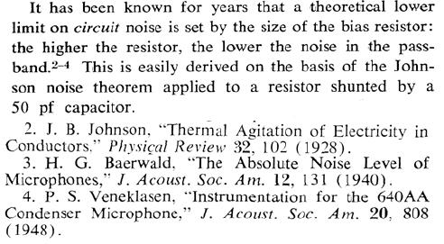

M. Killion, A Low-Noise Two-Wire Condenser Microphone Preamplifier, JAES April 1967
Gee Dimitri are you saying that someone realized the same thing in 1967 surprise, surprise, surprise? I like the wording (BTW there is a bit of history about Johnson and Nyquist and near simultaneous discovery). I still find Nyquist's example and reasoning a wonderful model of clear thinking.
