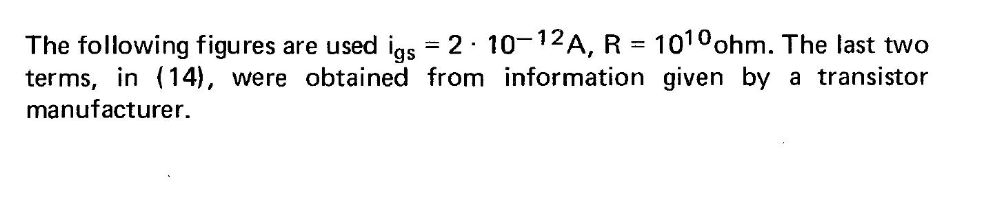

Again B&K Technical Review No. 3 1972 a great survey article on microphone noise. Companies release products and are very resistant to change them, the marketeers were happy at the time, who knows, but the engineers were totally on top of all the issues. John it's pretty clear you have no intention of giving ground to anyone else's opinion or alternate views so these discussions are unfortunately a waste of time.

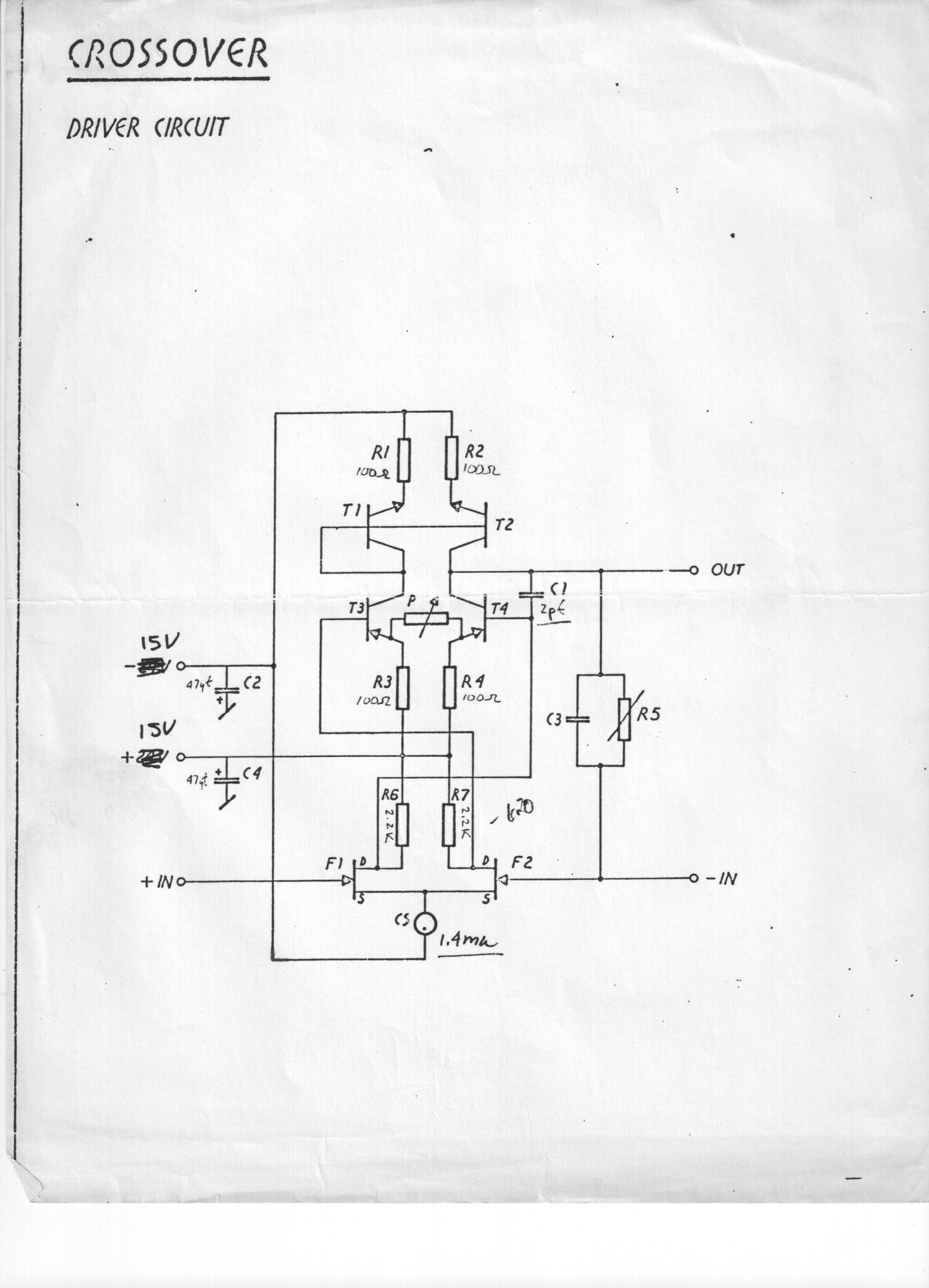

I didnt mean in this thread, Just anywhere.
If you have shared some innovative circuitry, post where you did.
For instance, where is the schematic of your single polarity differential jfet input stage?
