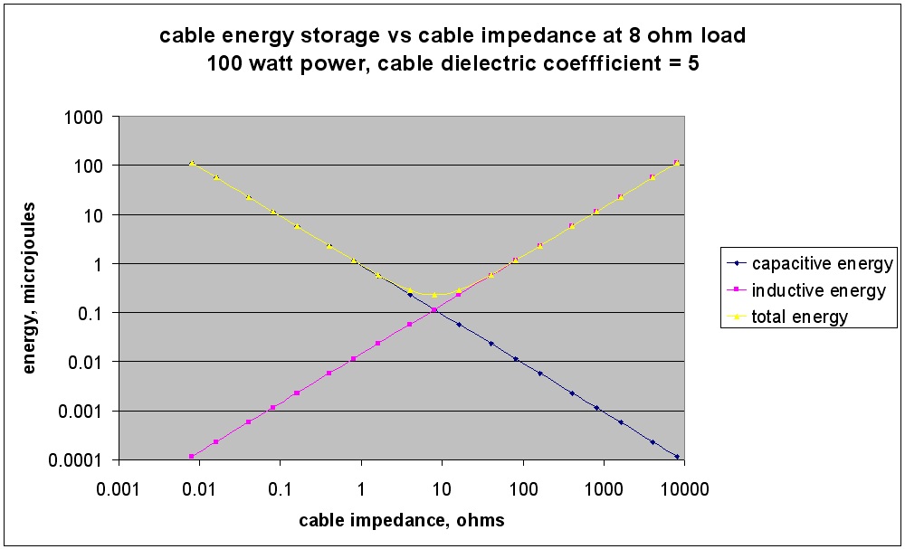

Agreed. Another way to look at it is by calculation of the energy stored within the cable. At pseudo-DC, which is generally the entire audio band plus, if the cable energy storage is predominantly capacitive, the amp will see that.
It can be especially interesting to measure the impedance vs frequency as seen looking into a 10-foot length of speaker cable when it is terminated in (a) a short; (b) an open; (c) 100 ohms (often near the characteristic impedance of many speaker cables); and (d) 8 ohms. This measurement should be done out to at least 10 MHz.
Agreed. The only caveat to that is trying to measure in the audio band and how the meter interprets the results. Any line based delay mechanism will not be distinguishable from reactance/resistance. Basically, most meters simply calculate the V/I phase shift at the two terminals and calcs the amount of 0 degree shift signal vs 90 degree shift.
That is why I prefer to actually measure at the load. But that's a PITA..
pps..here is the calc of energy storage within a cable with load varied. I could've provided a normalized graph, but it is scaleable and consistent, it's most important feature is showing what the amp sees as line/load mismatch.
It basically shows that when there is a mismatch, the line has to charge either magnetically or electrically in order for the load to see the V/I demands expected. And when matched, the travelling wave from the source to the load completely charges the line and provides the load what it needs in terms of V/I. Don't be thrown off by the units btw, as a simple calculation of a 10Khz square wave energy per lobe will show that the energy levels displayed cannot be brushed aside.
jn
