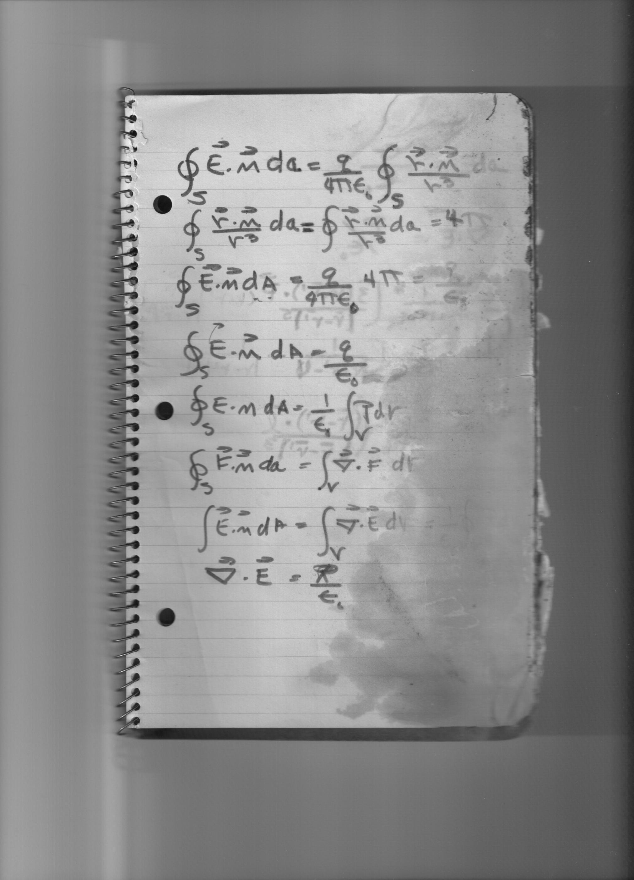

Help! I found an old notebook with some of my stuff that has been stored for at least 25 years. It goes back to 1959 for the first entry, so it is interesting (to me).
However, this page has an entry that must be between 45 and 50 years old, but I can't exactly place its origin. Can any of you math wiz's help?
