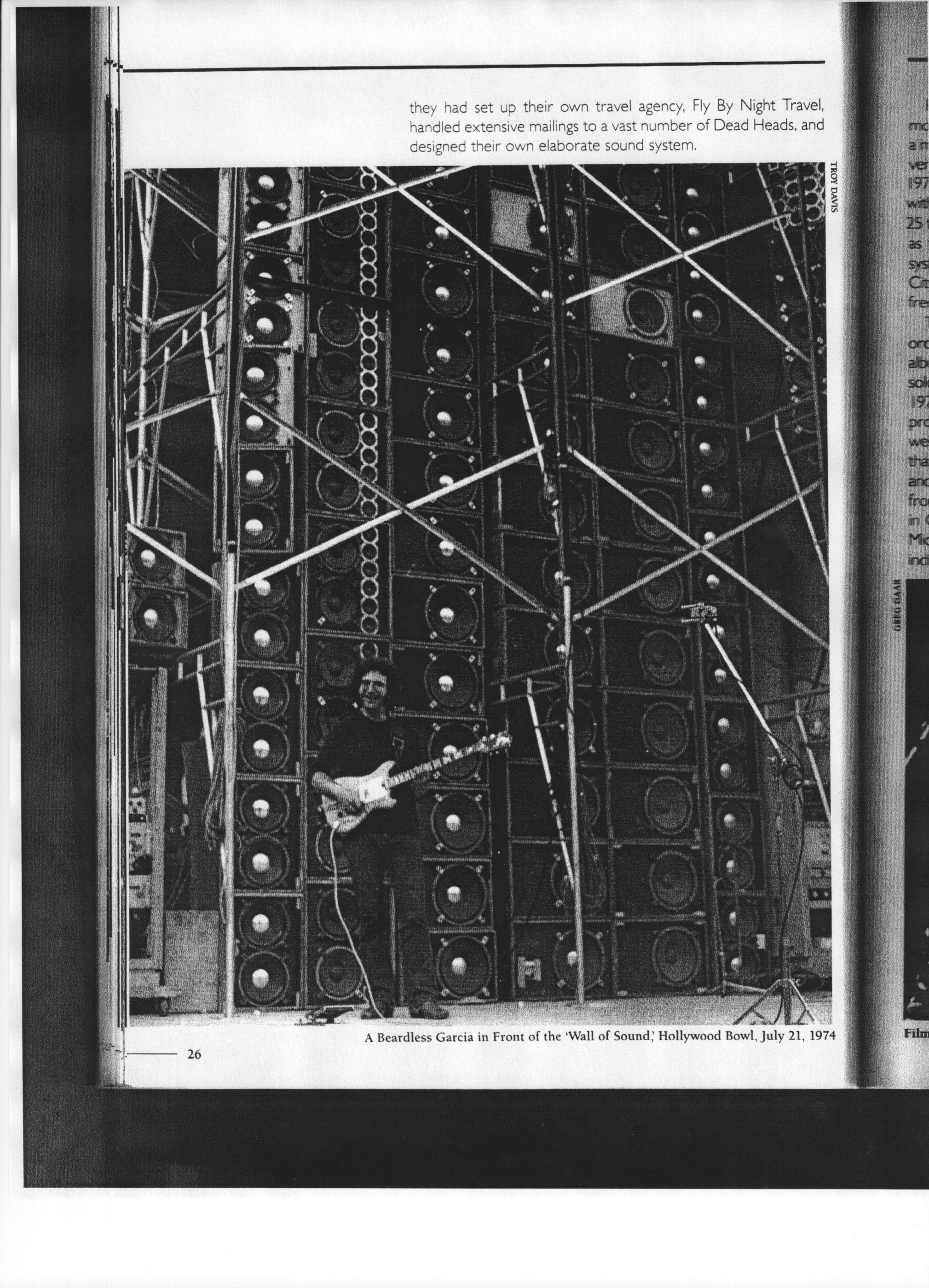

Esperado, this is what replaced the GD system, 40 years ago, and I helped design it at the time. It was developed to REMOVE horns, except for the tweeters, to minimize horn throat distortion that was so prevalent in the earlier PA. You are arguing with experts here.
Are-you talking of the crazy Grateful Dead PA system ?
With such a surface, and such a distance between speakers playing the same sources, the directivity lobes were so incredible than you where able to make your own mixing, simply by moving you head some centimeters in the middle of the hall !!!! Hard to find a point where all instruments could be heard together.
And the out of phase mikes for the singers, to cancel the enclosures behind them; so near of the Larsen point, where not a so good idee for voice quality.
For me the most enormous mistake in the PA history. While the idea was very original.
(I have some experience and knowledge too, despite i do not pretend to be an expert.;-)
To be fear, the expensive idea to do not mix sources, but provide separate amps and enclosures for all of them was brilliant.
