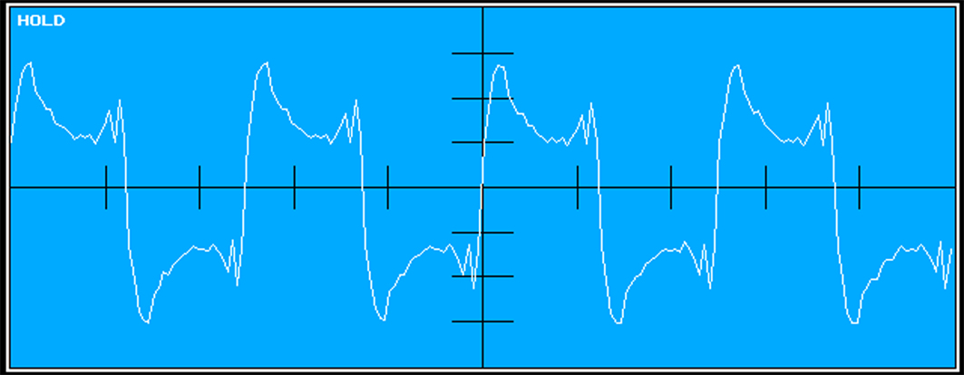

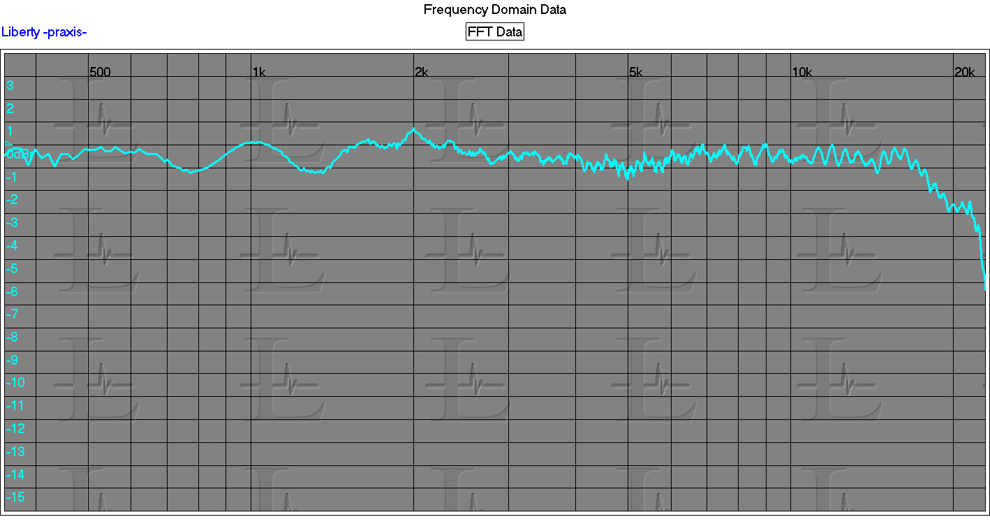

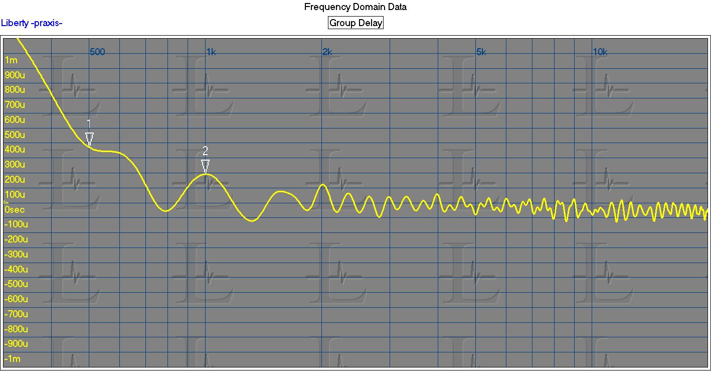

About time alignment, it is a minimum requirement for a hifi home enclosure, of course. Not enough, on my point of view.
We can use use digital filters to linearize further both response curve (and reduce some room resonances) and group delay of the whole assembly. You can achieve this for the response curve (those curves are from the Moonlight project, i get similar results with my own system.):
http://www.moonaudio.fr/Photos%20taille%20affichage/Amplitude%20fr%E9quence%20@2m.jpg
and this for the group delay:
http://www.moonaudio.fr/Photos taille affichage/group delay.jpg
with as a result, on a 1KHz square wave:
http://www.moonaudio.fr/Photos%20taille%20affichage/Signal%20carr%E9%20miniMaX%201kHz.jpg
