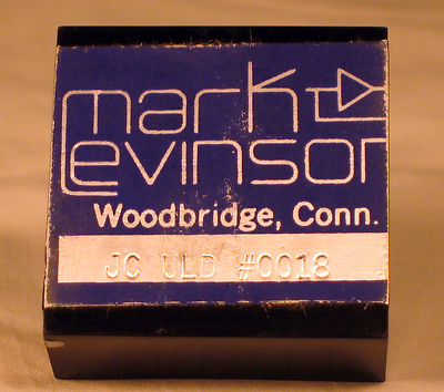

A bit related to this thread's subject .. look what I've found while browsing some places in Far East. :)
JC ULD !
John, what is it? One of your GD line drivers? What does ULD stands for?
Best,
First, Esperado, let us not talk about ABSOLUTES or correctness. Parasound has a number of different customers and we have to worry about their complaints. However, I agree that a long delay could be damaging to the loudspeakers.
Electroj, WOW! Yes, I think you found an ORIGINAL GD driver, from 1973. Inside, it looks like the line amp for for the Levinson JC-2, except that it uses TO-5, 2A output transistors, and runs about 50 ma. How much did they want for it?
John,
I did my best to find the link and it turns out it wasn't in Asia, it was in the US of A:
InstrumentsFair.com - Mark Levinson discrete op-amp Model JC ULD
(Scroll down)
Unfortunately, the module is no longer available :( , but you might know who the seller is ...
Best,
