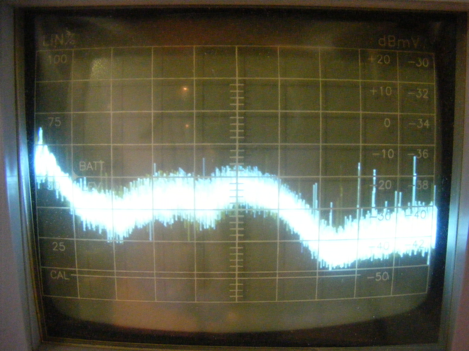

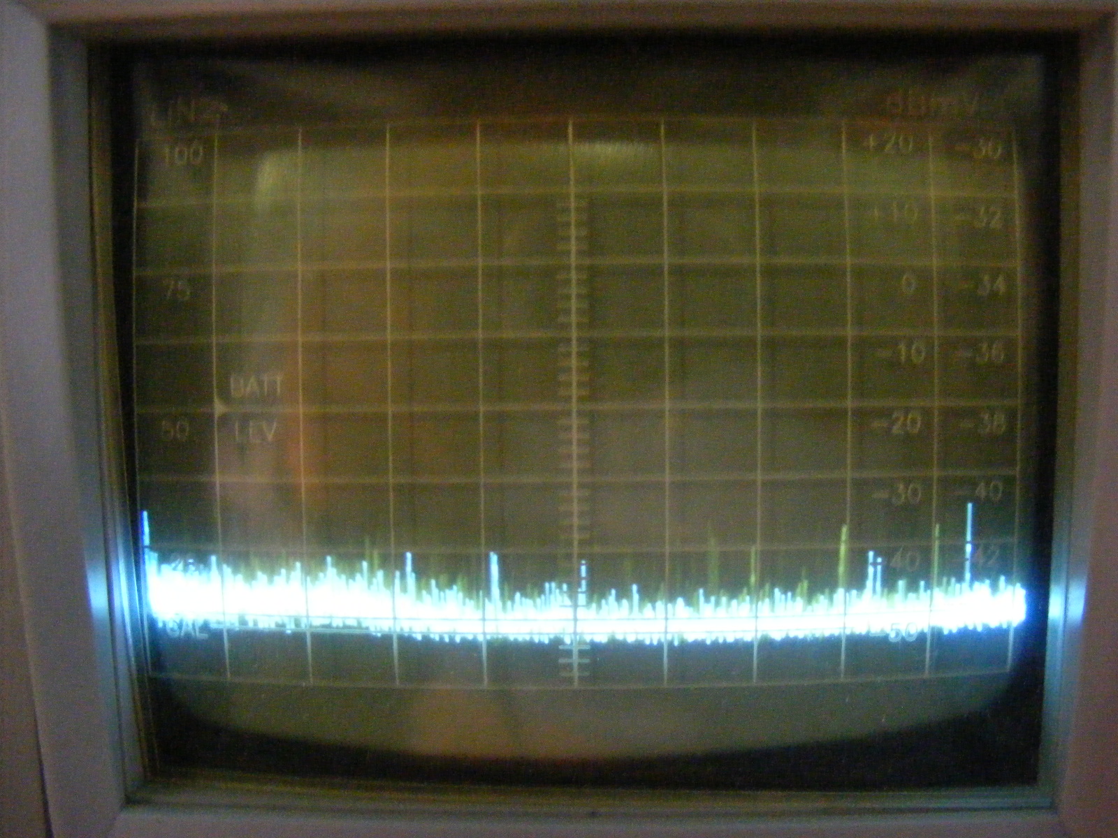

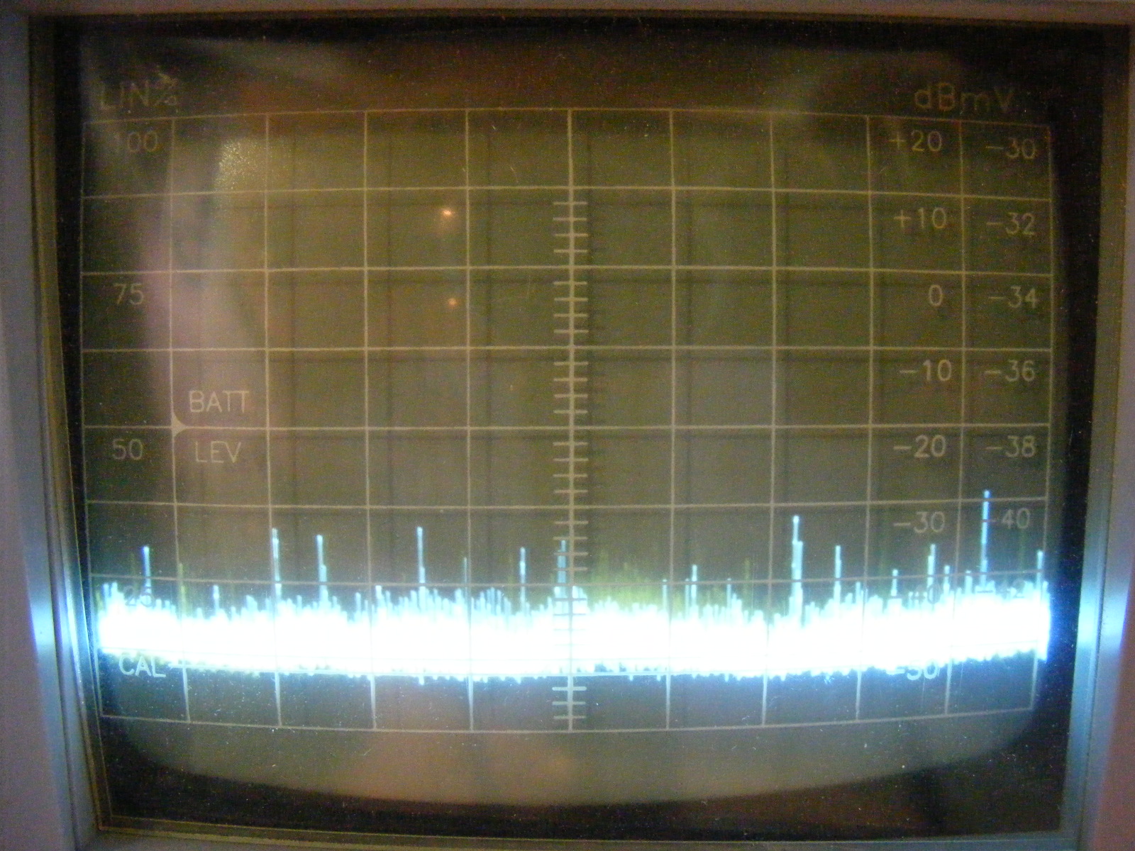

Here again are the measurements on power supply noise. With an ungrounded pair of diode bridges the power line noise only passes when the diodes conduct. Since they are on less than 30% of the time you get about a 5 db reduction in noise. Adding caps across the dual diode bridges improves things even more.
So John had an idea, tried it, found it worked and keeps on doing it. Sometimes the original idea is the correct mechanism and sometimes it isn't! But either way if it works, it works.
Shown is:
Dual Diode bridge W/O common Ground
Same with Diode Capacitors
RF noise from the transformer
Bandwidth is from around .1 to 5 MHz.
0 db is 1 mV
So the RF noise goes from 500 uV to 10 uV with four diodes and eight small capacitors.

I think rectifying and smoothing each secondary separately and then connecting the ground of one to the V+ of the other to create a split supply is the most sensible way. This way, you absolutely keep he cap charging currents separate from the signal ground, making is easier to create a low noise supply. I also put snubbers cross each rectifier (c. 1nF and 470 Ohm resistor). A transformer screen takes care of noise that couples from pri to sec via the interwinding capacitance, although i found off the shelf PCB types dont have these- but if you order them custom, it pays to specify them Finally, a good filter on the main input side works wounds for RF conducted noise.
No magic here. These techniques have been used in instrumentation for at least 40 or 50 years.
