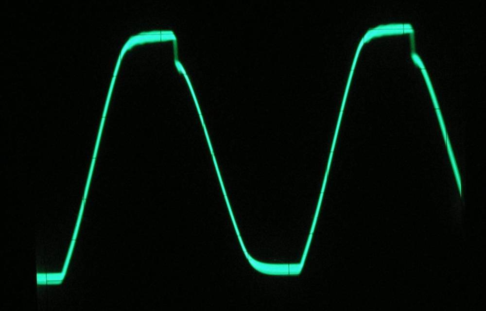

Hi all
destroyer X has posted that the JLH-update he built (at lightning speed) needed some mods to work with his 2SC5200 outputs.
I'm not surprised, simulations showed that the circuit was not so hot with fast outputs.
I've tested the "flipped" version of the circuit posted (NPN inputs, PNP VAS) and it seems to be fine.
Image shows a (pretty poor) photo of clipping with amp running from 35V rails at 20 kHz with MJ15003/4 output pair. "Noise" in the clipping parts is not oscillation - just poor regulation from the power supply.
I'm working on a mod for fast outputs. Will post if that works. So far seems to give good simulation results even for quasi (OK for BDY56's? Sorry, no can do for 2N3442!)
cheers
John

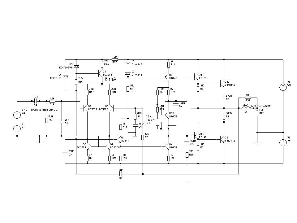

Hi all
Trickier to develop the fast-output version of the JLH update ciruit, but have a working solution.
Choices of the output configuration! With the "sprog stopper" capacitors C9, C3 in the circuit below, it is possible to connect the stabilisation capacitor C8 either as JLH originally placed it between the VAS and base of the feedback side of the input stage, or as I have shown as a "deferred" Miller.
The deferred Miller capacitor was suggested by Cherry to improve distortion. Simulating the three options (a) as JLH connected it (b) as I have shown and (c) as a true Miller shows that (a) and (c) have similiar crossover distortion but (b) is lower.
Version (a) shows some spikes on a square wave test, so seems to be slightly less stable. You can try different options but the method shown seems to be giving the lowest audible distortion (overall distortion figures are slightly higher than the Miller, but audible distortions are lower).
Measured performance gives about 300 kHz bandwidth with the 3 uH choke, without input filter capacitor.
cheers
John
