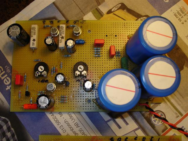

not that more complicated
P Robertson, I wouldn't say the Sugden is that more complicated than the JLH. In essence I think the Sugden has also 3 gain stages if the output is seen as a Darlington-pair. For the jlh-2003, which has some extra transistors for regulating bias and offset, the differences in components-count vis-a-vis the sugden is again smaller. The Sugden is more efficient and can put out 2 times the idle-current, where the jlh has a figure of around 1,3-1,5. In other words: for 20 Watts RMS you need 1,1 Amps for the Sugden and around 1,7-2,0 Amps for the jlh (depending on the version you choose). Of course, both amps are inefficient as you compare it to for example a Hiraga which can still work in class-AB when choosing a small idle current. Another point: the Sugden article is written after the original jlh-article (1970 and 1969) and James Sugden explicitly refers to the article of John Linsley-Hood. The picture shows you a hard-wired version with all components (excluding power transformer and bridge) for one channel Sugden.

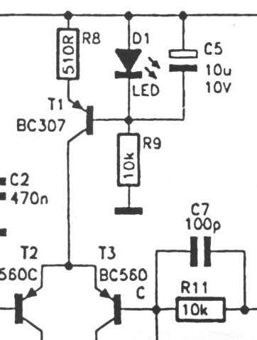

CCS on LED/transistor? Why not?
Dear Geoff,
maybe I missed somth, but why not to use simplified CCS based on one transistor and one LED?
This is much simplier way compared to 2 transistors and 2 pots?
It is no easy to bias such thing...
Even Marantz using leds/diodes in power amp schematics for that purpose...

Re: CCS on LED/transistor? Why not?
Hi kesrmk
In terms of component count, there is not much difference between the two transistor ccs and the LED/transistor version. I chose the former for several reasons.
In the dc offset ccs (Q5/Q6), the Vbe variation with temperature of Q5 alters the ccs current in such a way as to negate some of the output dc offset change due to temperature variations in Q3 and Q4. Thus there is less output dc offset drift with changing ambient temperatures and during warm up.
Also, JLH himself used this ccs arrangement in the input stage of another of his power amp designs and so I was keeping with something that the original designer had used.
The advantage with using the two transistor ccs to set the output stage quiescent current is that the reference voltage is the Vbe of Q7 (~0.6V). This is less than that for an LED ccs so the peak output voltage swing, for a given rail voltage, will be higher thus giving a (slightly) greater efficiency.
Geoff

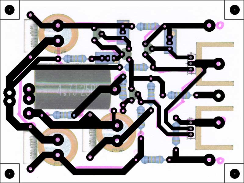

Hi
I'm a newbie of JLH.
I'd like to try to bulld one of my own, so I spend a little time to draw a driver for it.....
The Q1/Q2 and R10 will mount on heatsink, using hard wire to connect the driver.
please kindly check if there's anything goes wrong or oscilate.
If all of you think it is OK, I'll post the solder PCB.

Not that anything is wrong but a suggestion...
Looking at the JLH schematic u have 3 current drawing branches viz the 2 ccs and the o/ps
At the filter capacitor, make a star point and take two separate tracks to the 2 ccs. It will be better since both the currents will seperate out. Anyhow u have lot of real estate that will go waste. Do the same for V- and ground.

Coffin wrote
No, the earlier one is better. U should make branches at the capacitor.
3 branches for Q5, VR1 and Rcp
2 branches for R5. Rch
Connection E should go to C- first and then to C+
Power xtors should get connection from filter Cs
